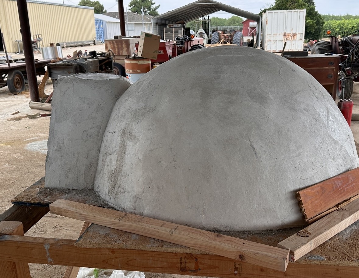

    Hey everyone. We’re 1 week and a day out from my intial cast. No cracks formed except for hairline around the joint. Success! I took off the front form for the gallery and I did find some mistakes that I could have prevented if I was more careful. I had my Buddy measuring where it was thick enough and I think he missed a spot. Anyways I don’t think it’s detrimental to the structure and I can put a facade on to cover it.

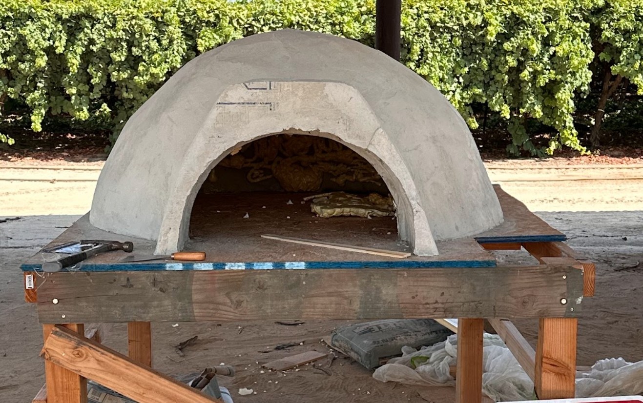

      Today, 2 weeks post cast, I removed some of the form to get a peek at the inside. The fiberglass is slightly transparent so I can see that the interior of the dome, and it is void and crack free, thank goodness.
      I think David's suggested 3:1:1:0.5 blend was a very good one, with stainless steel and AR reinforcement. You can tell that its very binding, especially on little bits that come off. When there's a stainless steel needle going into it, it provides so much strength to the cement.
      There are a few mistakes here and there that if I were to do it again I'd fix, like making sure I don't miss adding thickness in certain places. Also having a better form for the gallery. I admittedly botched this one together, but it did the job.
      However, I have a bit of a problem that I definitely need help solving. With my form, I made a mistake on the gallery, instead of doing a hole for the flue that contains a recess that I can sit the vermiculite on to create a compressive layer for expansion and contraction of the flue, I just made a 9 inch hole. Worst comes to worst, I can probably put a form in there and stuff some mortar into it. and stick my flue in using david's method of installing flues. Please let me know any other suggestions or concerns that you may observe. Thanks.

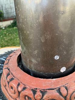

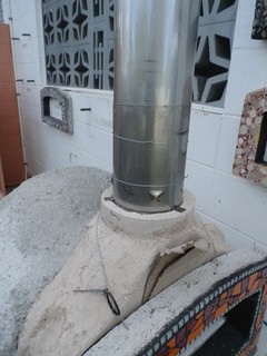

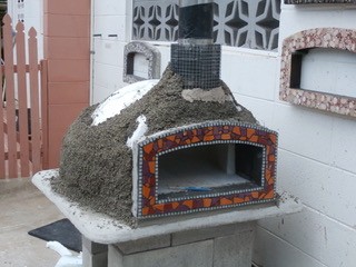

        For a mobile oven you definitely need to have a removable flue. You don't want the thing flapping around in transit. I've done at least half a dozen of these and developed a simple method by making a sleeve into which the flue pipe can slide. I'll let the pics tell the story. You may develop a better or simpler solution so post what you come up with to assist others.

          Finished removable flue.
          Click image for larger version  Name:	IMG_0686.jpg Views:	0 Size:	121.7 KB ID:	455226 Click image for larger version  Name:	IMG_0687.jpg Views:	0 Size:	102.8 KB ID:	455227 Click image for larger version  Name:	IMG_0688.jpg Views:	0 Size:	103.4 KB ID:	455228 Click image for larger version  Name:	IMG_0678.jpg Views:	0 Size:	123.1 KB ID:	455229I forgot to add I also make 3 little tags at the bottom of the sleeve to prevent the pipe sliding too far down. Click image for larger version

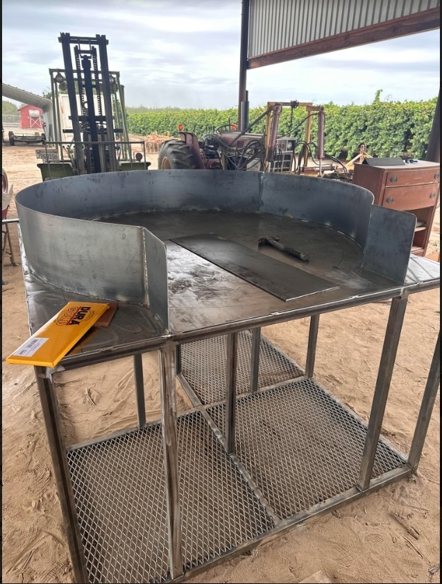

                        I just had my stand fabricated. I am now going to pretty much install my ceramic fiber board and fire bricks, and then use 10:1 perlicrete to lock it all in against the metal band. What are the different functions of 10:1 vs 5:1. I feel like I'd want to use 10:1 because I want a really high insulation value to prevent and heat from escaping out the edges of the firebricks into the highly conductive metal. Let me know.
                        One of my big challenges right now is finding a way to lift the very heavy one piece dome off its mold. I have the idea of sliding some straps beneath it and using a forklift to lift it up, but Im concerned about applying forces that might crack it. Only other option is to get 5-6 guys out there and lift it, but it's so heavy that Im worried someone might get hurt. Anyways, I'll continue to upload pics of my progress. Click image for larger version

                            I don’t know the weight that the stand will be required to support, but a 48” oven will be heavy. Without a closer inspection and from a small pic, it is more difficult to judge, but if it were mine I’d be adding some diagonals,Remember that there will be additional stress because of the shifting load in transit from accelerating, braking, cornering and road vibrations. Diagonals add little extra weight while contributing enormously to increased strength.
