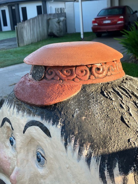

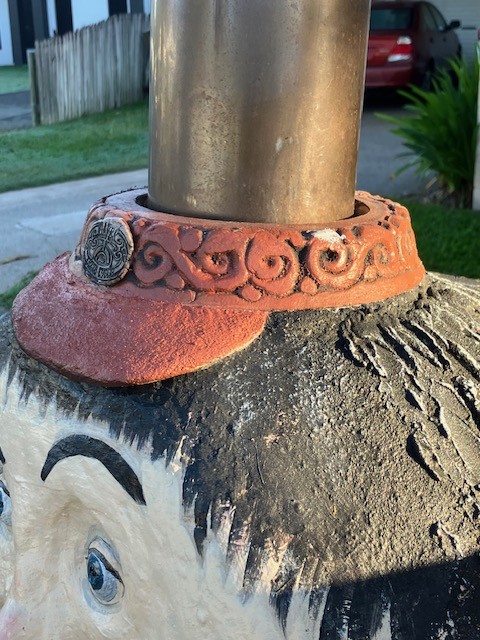

    I made a terracotta cap that fits the inside diameter of the flue sleeve. You definitely need a removable flue pipe when travelling.
    Click image for larger version  Name:	IMG_1034.jpg Views:	0 Size:	123.0 KB ID:	458671 Click image for larger version  Name:	IMG_1033.jpg Views:	0 Size:	115.6 KB ID:	458672
