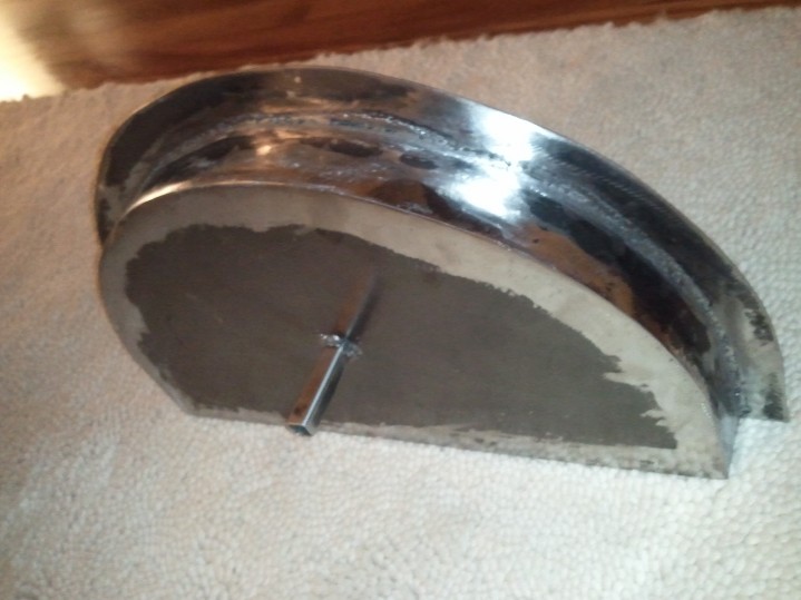

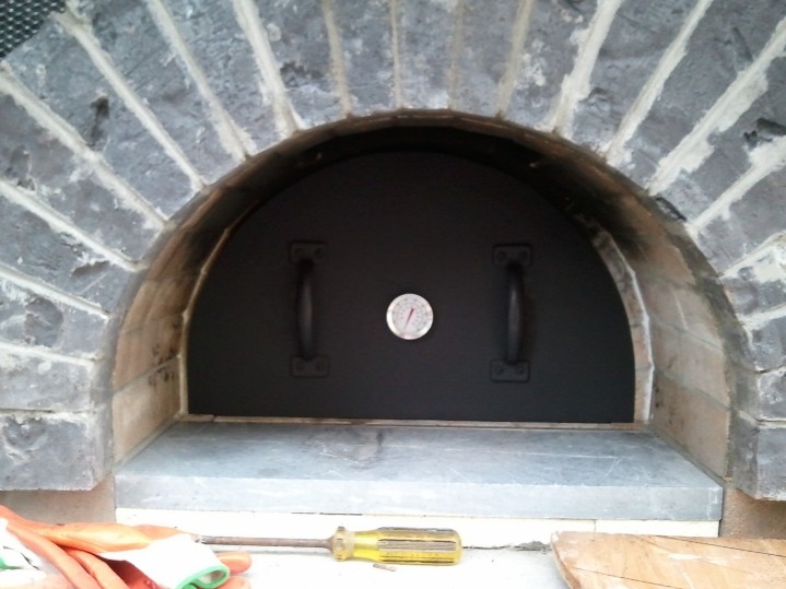

        I'd go with the metal on either side of the insulation. For the edge, I would suggest maybe cutting (or ordering, check out onlinemetals.com) a 2" strip of steel (or whatever you are using). Bend that to the shape of your arch, and buy or make some small "L" brackets to hold it to the back plate. You don't need to secure to both sides, since you are running bolts through the plates.
        FWIW, I bought a used HF flux welder off of craigslist to build my door. $80 for a welder + mask. It was pretty fun learning to weld, and the end product actually came out ok. It took a lot of grinding to get it smooth, but it worked! If you have the materials cut, it's also pretty easy to find people on Craigslist who will weld it for you for an hourly charge. That cost will be much less than the cost of fabbing a complete door.
