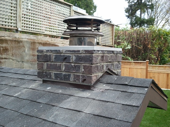

        If you were to use stainless along with a gable roof enclosure how would you flash the outside of the pipe would you need double or triple wall pipe
          Re: Brick or Stainless
          A double walled flue should be fine, flash it with a dektite.
            I used double wall with a gabled roof. I built a chimney chase around the pipe, and flashed the top with a chase cover and storm collar. Seems to be working fine. I think it depends on the look you want.
            This picture is before the storm collar went on, but with the chase and chase flashing
