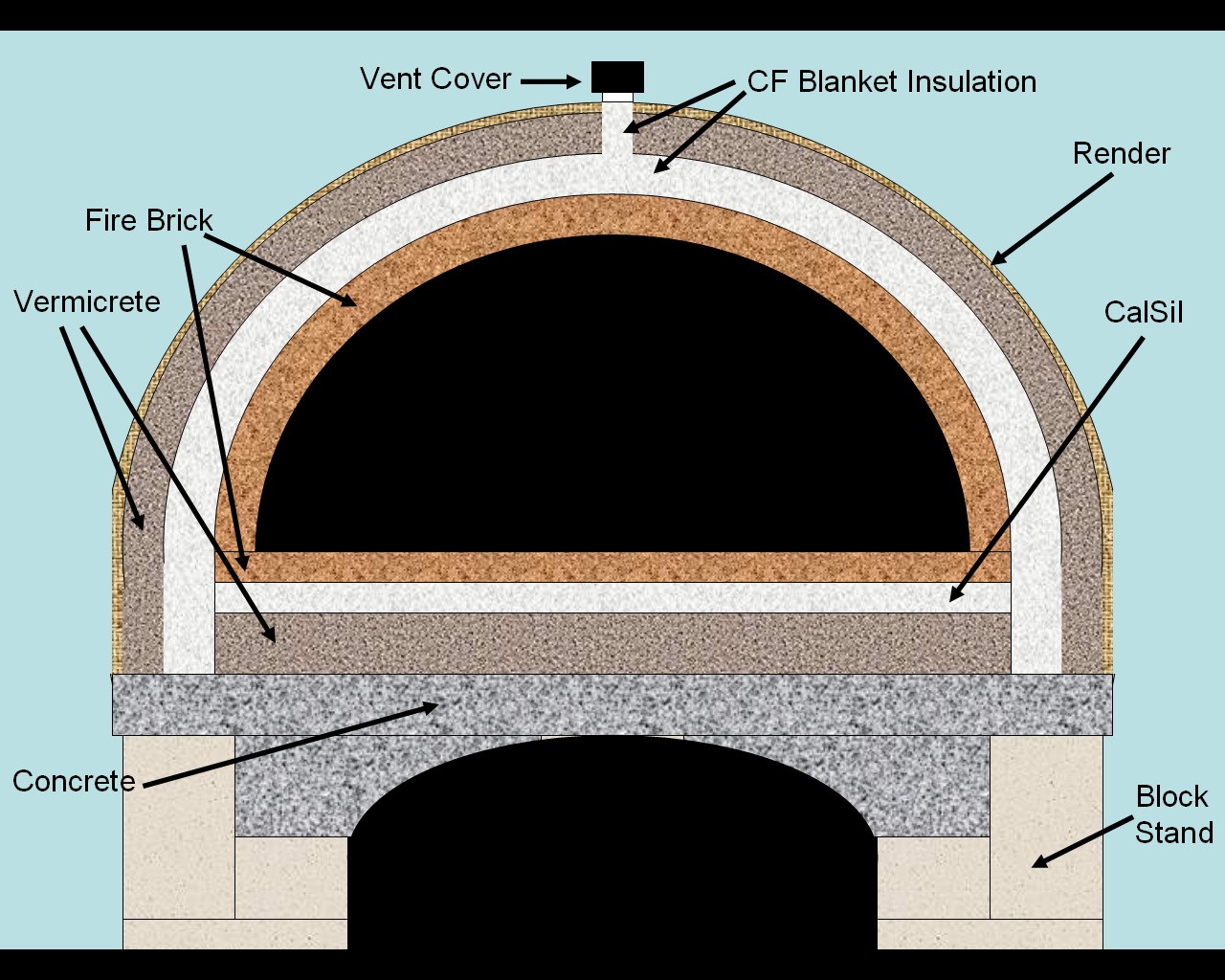

                I reall couldn't tell by your sketch if you understand that the dome and floor have to be totally incapsulated in insulation and separated from any face brick or concrete which may leach away heat. My sketch is of an igloo, but the priciple is the same.

                  Re: Design Help
                  [ATTACH]43098[/ATTACH]
                  Well there is a spanner in the works
                  Thanks for the heads up Gulf
                  Makes complete sense though... I will modify my idea to accommodate and repost
                  in terms of the walls and floor of the oven I have a firebrick layer (25mm thick) followed by a clay brick layer (100mm thich), on top of this would be the insulation
                  is this enough of a heat trap?

                      Re: Design Help
                      Neil,
                      I have been following your thread with Gulf, he knows what he is talking about. Vcrete is a decent insulator but not as effective as CaSi board (floor) or ceramic fiber blanket (dome) so the Vcrete has to be thicker to achieve the same level of CF thermal insulation. Nothing wrong with Vcrete, just to plan accordingly for the added thickness. I have 4" CaSi/FoamGlas on floor and 3" of CF plus 2" of Vcrete on dome. Oven holds heat for 4-5 days with outside of dome at ambient air temperature.

                        Re: Design Help
                        Neil,
                        Thanks for the info mate !
                        I cannot find anything other than Vcrete so i think it will have to do ....
                        What do you think of the clay brick and firebrick layer?

                            Re: Design Help
                            Neil,
                            I believe you are building a barrel, so the two layers are not near as complex cutting as a dome. The total brick thickness is just under 5" so a little thicker on the barrel and quite a bit more on the floor. It may take a little more fuel to fire the oven but you use what you have to work with. I have no scientific documentation but the word of mouth is Vcrete is about 1/2 the thermal efficiency of a CF blanket. So 6" Vcrete equal to about 3" CF. Again, like Gulf says and your latest sketch, insulate the barrel, floor, and walls away from the reinforced concrete hearth.
