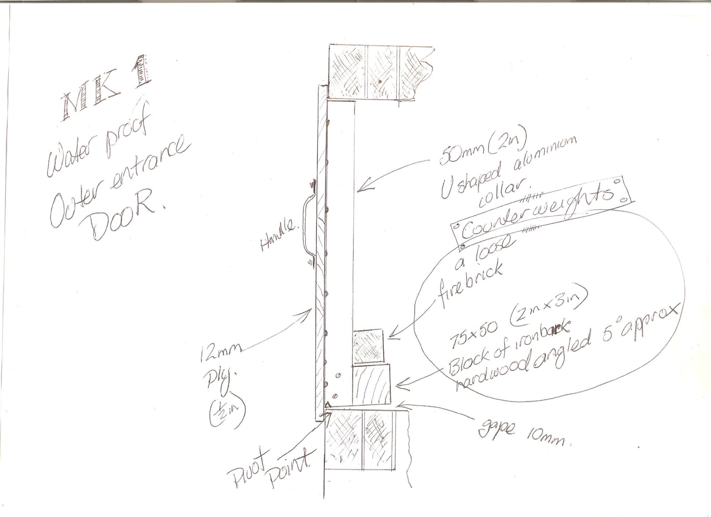

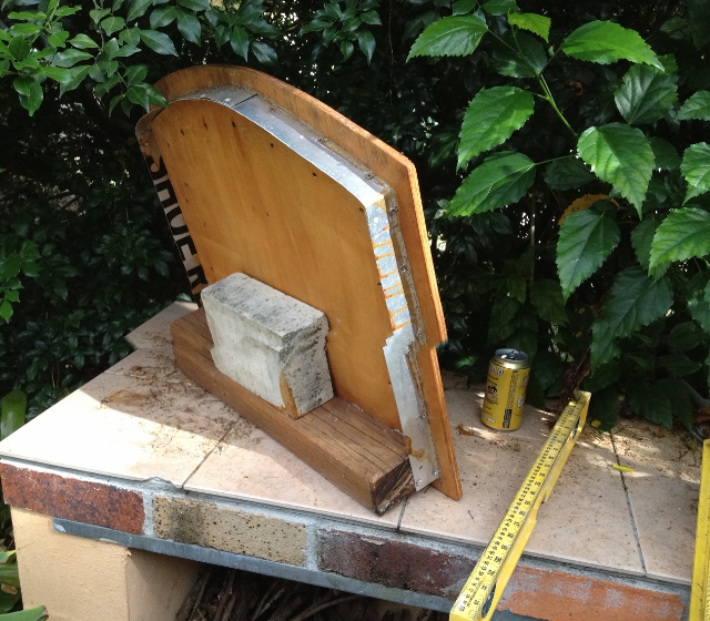

    Anyone that has ever dropped a firebrick in a bucket of water will find out they soak up water real fast, they are not like a house brick which are designed to resist water.
    I found I needed a waterproof door to prevent wind driven rain from soaking the hearth firebrick. Any water on them and the moisture wicked straight into the insulation layer, and was always a lengthy task to dry out.
    I wanted it attached well so it didn't become a wind driven missile during our summer storms. A neighbour was nearly taken out by my BBQ lid in a storm one year, so this was important.
    I didn't want to have any hinge's or fasteners drilled into the front of the oven so I came up with this
Name:	waterprrof door 001.jpg
ID:	320729 [ATTACH]Click image for larger version
Name:	IMG_0896 (640x560) (2).jpg
    Has worked well and survived a couple of storms, but being only built of ply is going to have a limited life.
    I'm not much of a metal worker but I think I'm capable to replace the ply with some aluminium checker plate. I'll certainly loose that brick as I'm sure to drop it on my foot one day. I'll replace it and the hardwood with a length of hardwood sleeper. They are 50mm thick and 300mm wide so that should provide some weight to the counterbalance. whilst I'm at it I will include a rubber seal as well.
    If anyone has any further thoughts or ideas....I'm all ears
    Regards Dave

    Dave.....great job w/the door. The only suggestion I may have.....and you may have thought of this.....is to make the top and sides of the door actually fit inside the doorway, so water would not be able to seep in around it. Then make an offset for the bottom, to divert the water away. It seems that the top and to some extent the sides.....are the most susceptible points. This is offered only as a possible improvement to an already fine door you have. I am going to be doing the same thing (building an outer door) later on, when the time comes.

      That's what the. 2 in aluminum collar does . It fits inside the oven entrance . Sorry I should have made the scan a little clearer.
      I even cut a "drip cutter"with a file closer to the door surface to stop the drips from heading back . Seems to work . Thanks for the input
      Regards Dave
      Ps NCman feel free to pick the sh!t out of anything else . I'm stuck with a workable waterproof door. Temporary materials but it could be better before I build the permanent door.

              Hey Dave - I see nothing much to be improved on with your door. You already have MK II in planning by the sounds and with something like aluminium checkerplate that will cop the weather as an exterior finish and a rubber seal I reckon you are on the money. Another option would be marine ply and a marine varnish finish if you want to keep it organic.

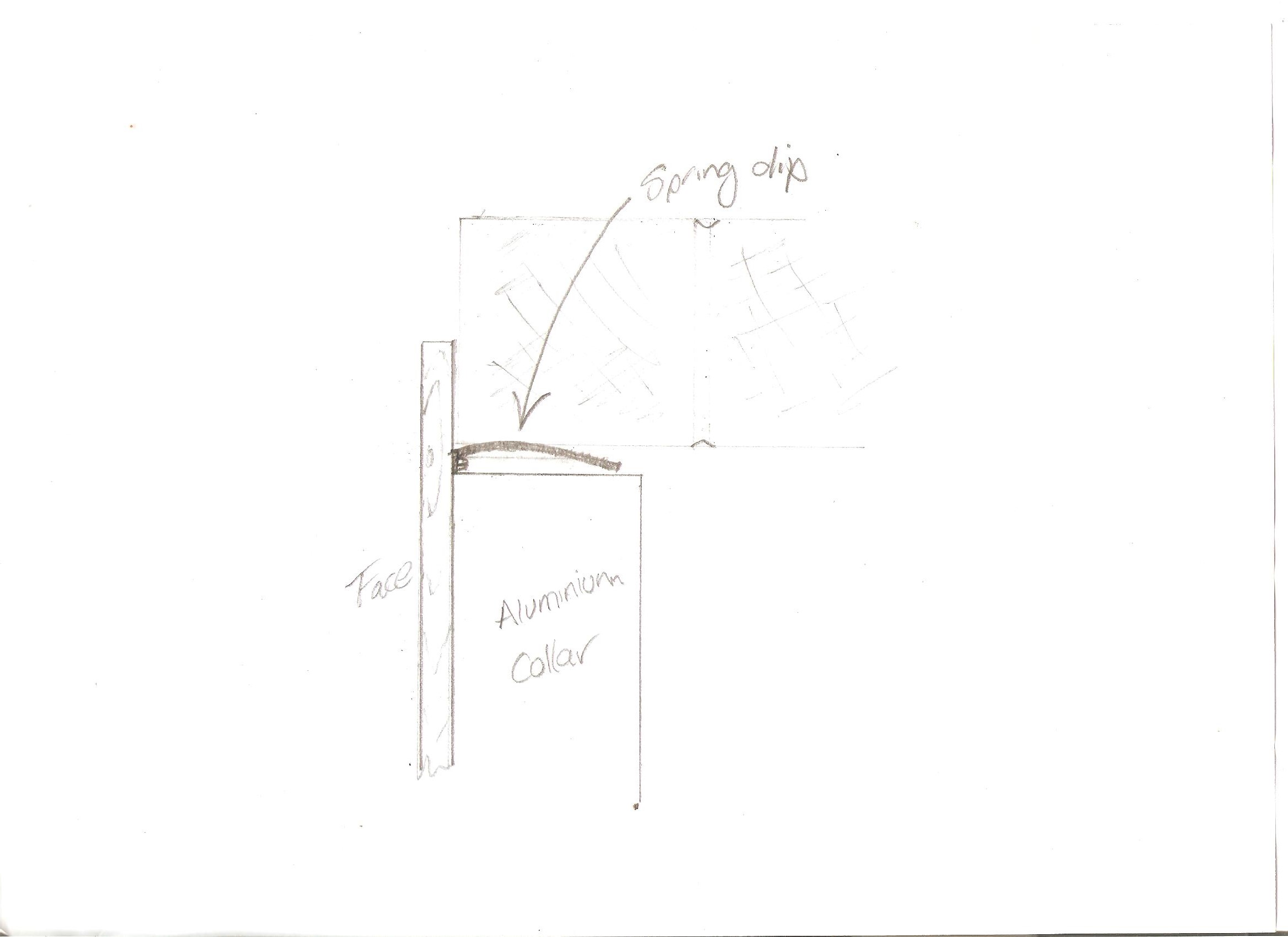

                  Hi Dave,
                  Have you considered a couple of spring loaded door stops fitted on the inside of the door to press against the top or bottom of the door opening

                          Hi Dave,
                          Have you considered a couple of spring loaded door stops fitted on the inside of the door to press against the top or bottom of the door opening[/QUOTE]
                          G'day
                          When I first saw this I thought "crap this is the least possible thing for me to fashion" I really not a metal worker. But it stuck in my mind and I thought long and hard. The top of the door is the most likely to be blown open being the furthest from the bottom, the pivot point. Some sort of internal spring would be great. I got a piece of aluminium folded it in 1/2 and put it at the top and shut the door. Makes a great difference, definitely hold the top better the bottom rock solid already with the weight.
                          My plan is to include this clip at the top
                          Thanks Dave

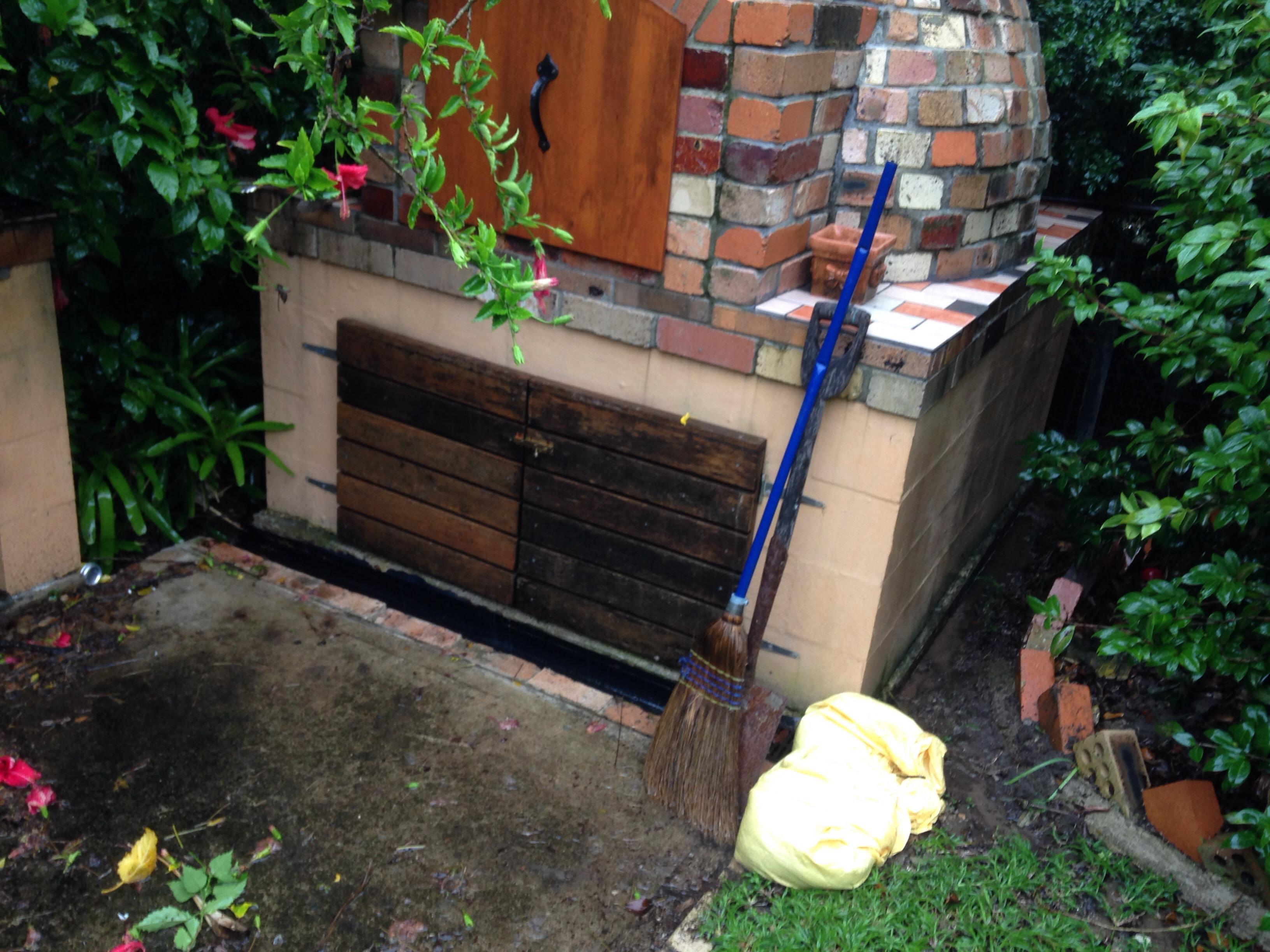

                              G'day
                              This year it was cyclone marcia. No I was not anywhere in the path of that , but the associated low and rains yes difinitely. I've pored out 370 mm out of the rain gauge in 4 days.
                              Outer oven door...... Worked well ..... Tick
                              Chimney cover .... A couple of bricks just in case the wind picked up .... Again a tick.
                              House bricks over dome and tile surrounds ...... Shed water like a champ...... Big tick
                              Grated drain in front of oven stand/ wood stowage.... Big X...
                              Dismal but the rain washed leaves and sticks filling the drain and grates. Same with the side of the oven filled with sticks and leaves and the water flowed down the front of the oven.u
                              The stand and the dry wood are now soaked. That moisture will wick up into the oven and its insulation and it will take time for it to dry properly. Rising damp is very real and capillary action really sucks!
                              Of course you'll build with a moisture barrier under the slab. But if I could build again I would include a secound moisture barrier under the insulation of my oven. Even if you think it could never happen to you a moister barrier is a very cheap and easily fitted thing. Next time you look at a pick of a completed oven have closer look at the pavement level at the front of the oven. 9 times out of 10 it's about the same. It's not something we all factor in when we start. So the pavement gets done last and is always a bit higher than you would like.
