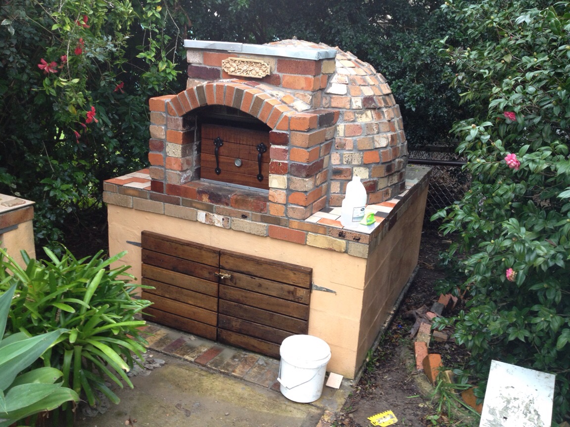

            G'day
            I've covered my dome with house brick split in 1/2 lengthways. House r
            Bricks are water resistant and the structure is thicker and tougher now( kid proof). Just as importantly it lets me keep the igloo shape I like and no roof which is what I wanted.
