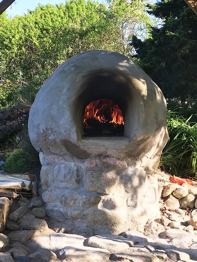

        I had built a cobb oven a few years ago. For what it's worth, and your "plan" may be different, I did not have a chimney or vent. The theory being air to feed the fire is sucked in at the lower portion of the opening, and exhausts through the upper portion of the opening. My oven worked great without any type of vent/chimney. Unfortunately the cobb material sucks up moisture and due to the moist environment where we live, my oven collapsed after 3 years. I'm now in the planning stages to build a brick wood fired oven. In case you haven't seen or read this book, I'd recommend it on building cobb ovens by Kiko Denzer . Good luck with your build.
