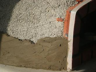

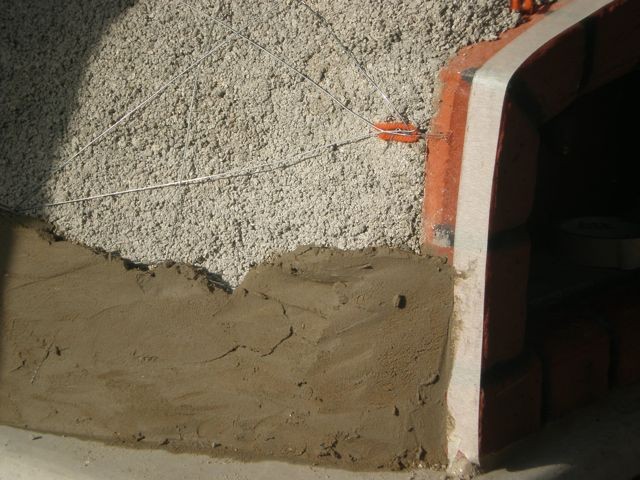

      Is it ok to fill in small voids and depressions in the perlcrete with the stucco mix? Or is it better to mix a small batch of perl and build it smooth first? Do folks usually add a layer of lath or stucco or chicken wire between insulating concrete and render?
        • 9211
        It is easier to fill any low spots with a richer mix say 5:1 or even some render mix and vermiculite 50/50. If you fill with render only it will produce an uneven coating thickness and use up lots more render. Any high spots of 10:1 vermicrete can be easily shaved with a brick trowel.I use a network of thin wires against the vermicrete for the render to bind on to. These wires plus AR fibres in the mix have proved quite strong enough.
