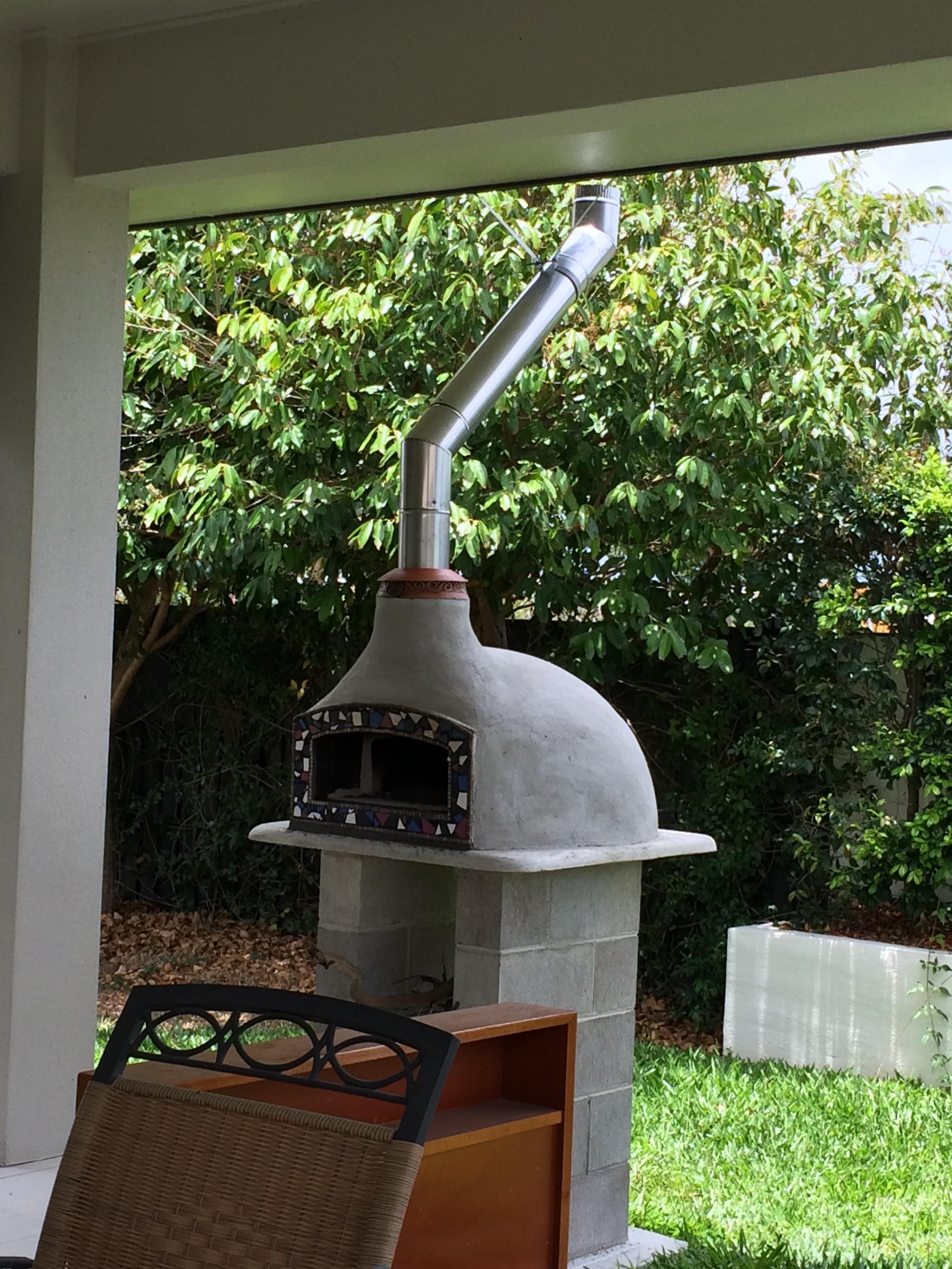

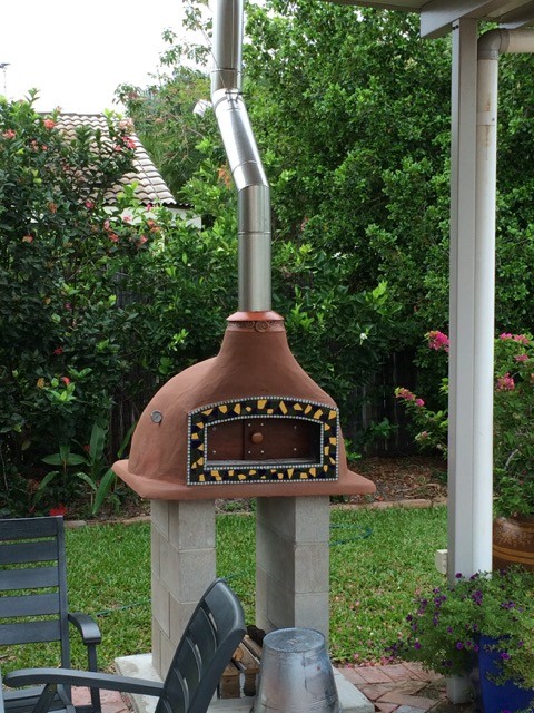

      I’ve done about 4 ovens with two 45 elbows to take the flue out past the gutter rather than penetrate the roof. I prefer that solution and the draft seems not to be affected (over the normal flue height of around 3ft), as the extra height compensates for the bends.

        David, thanks for the pictures and verification that 2 45's can be made to work.
