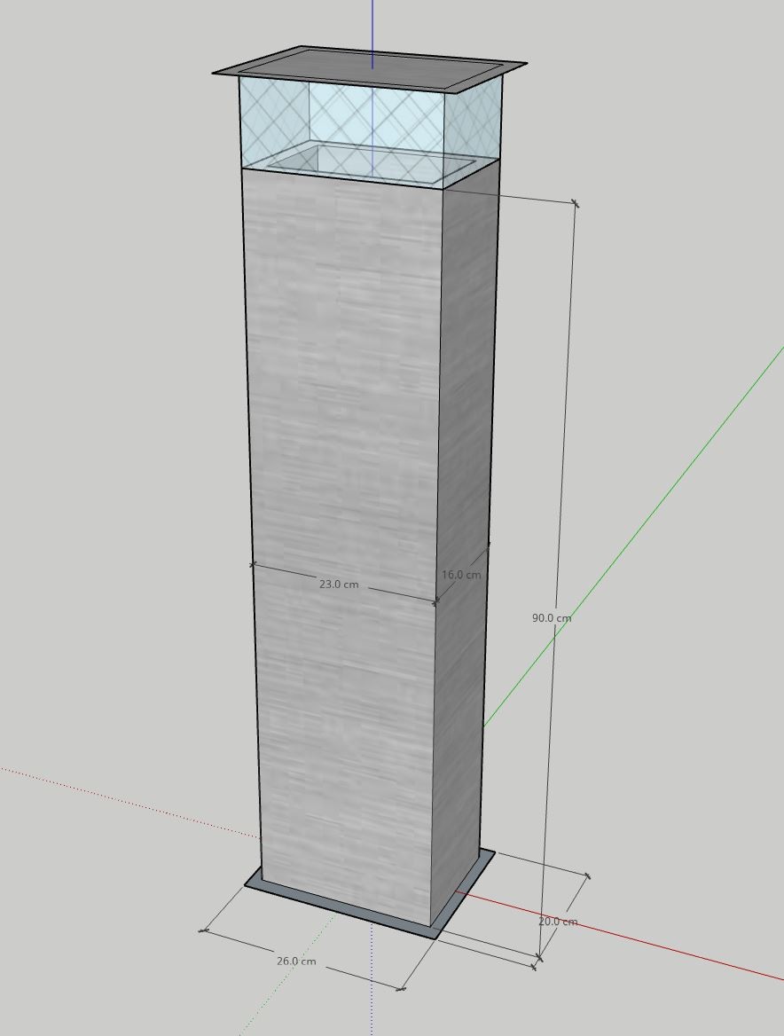

    Simple and maybe stupid question, does the chimney have to be a cylinder shape, or is a rectangular one okay?
    I've finished my dome and the opening for the chimney is roughly 12x19cm, so I'm thinking to make a rectangular chimney with those inner measurements, and then wrap an outer layer 2cm thicker and put ceramic fibre in between. Attached is a rough sketch

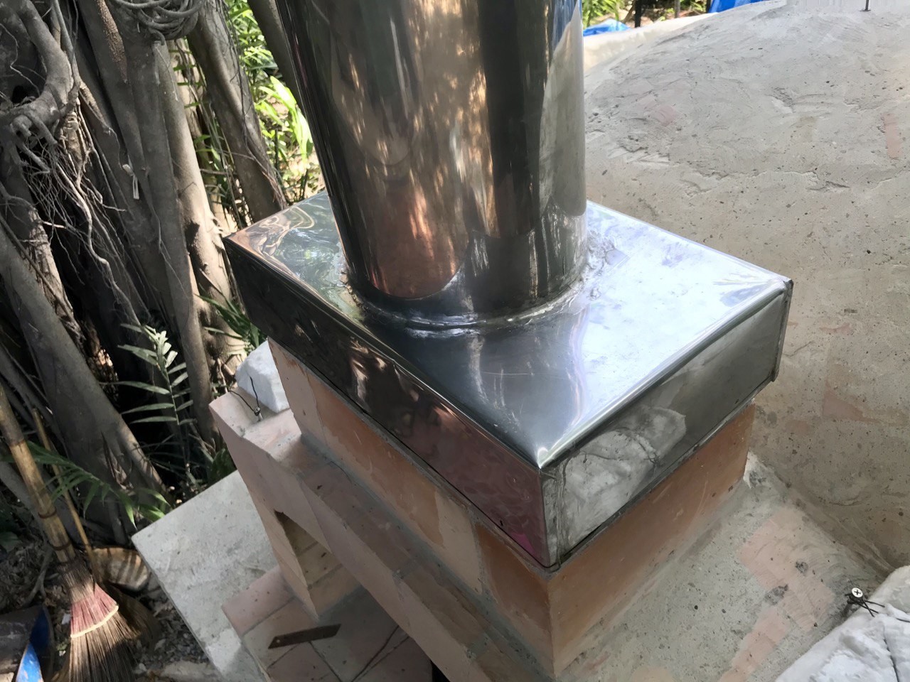

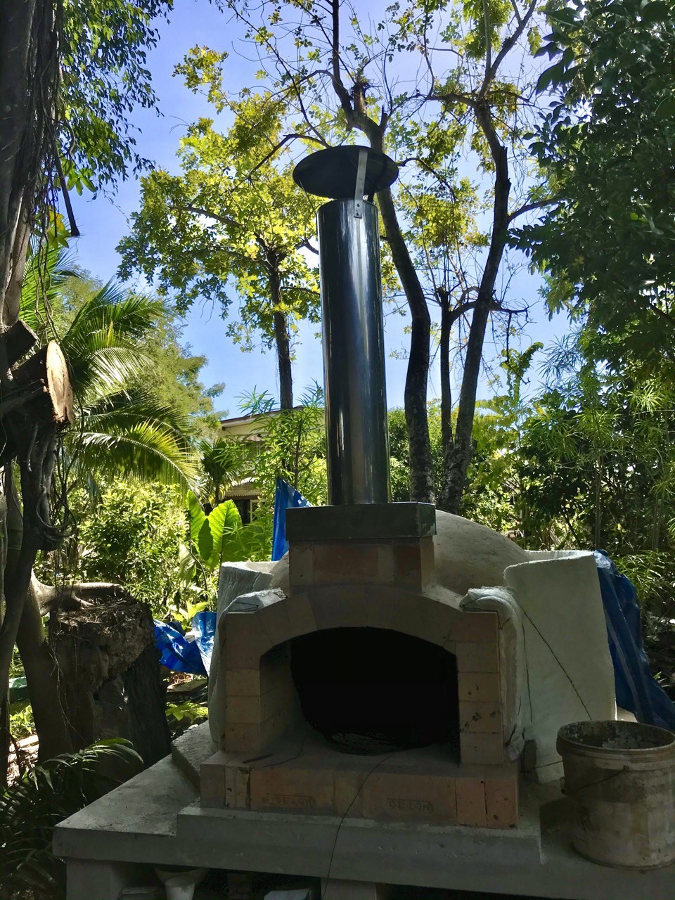

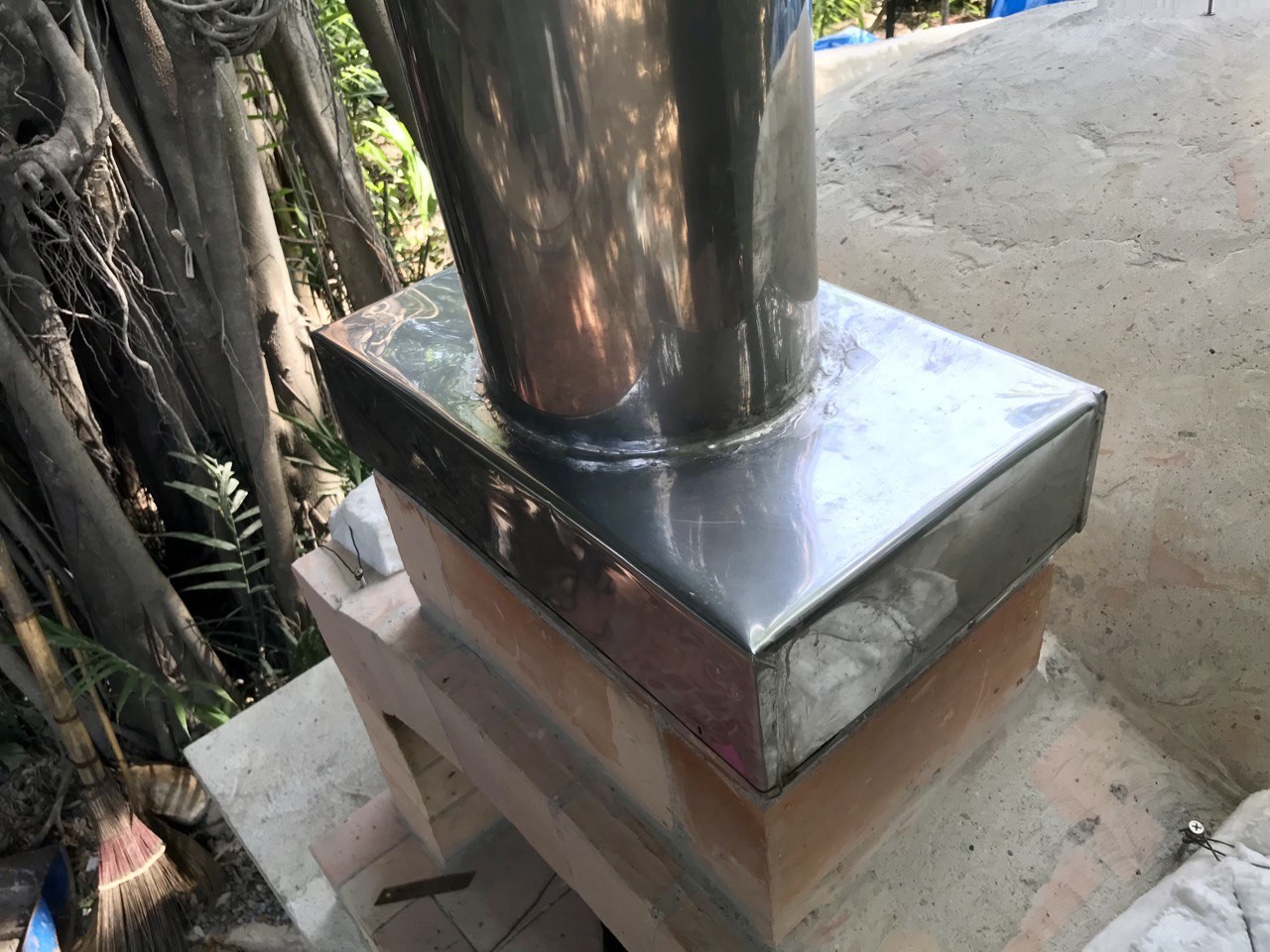

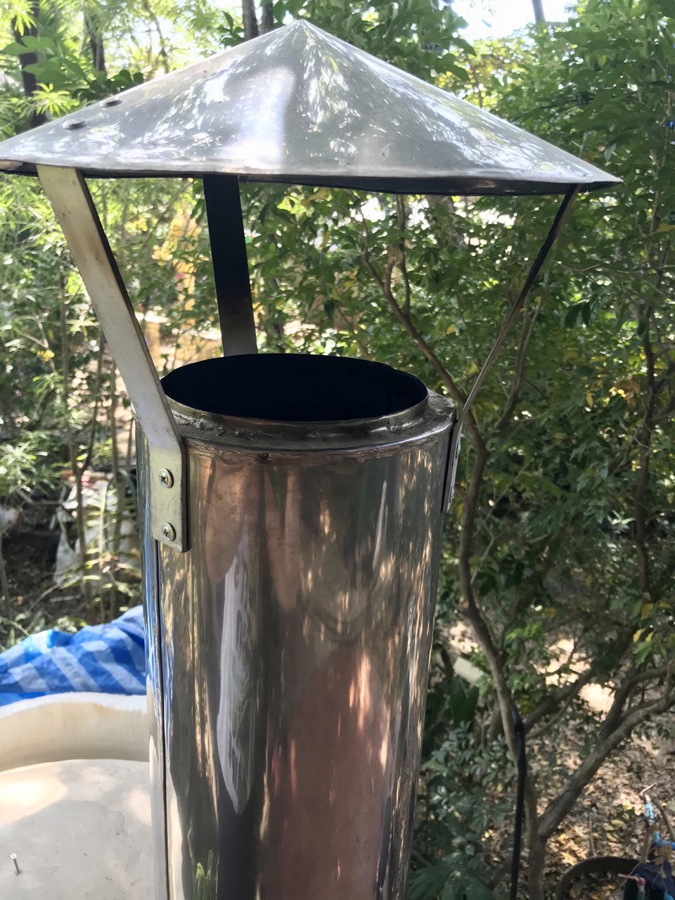

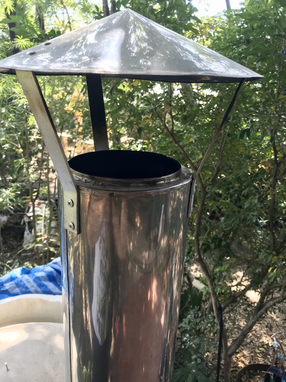

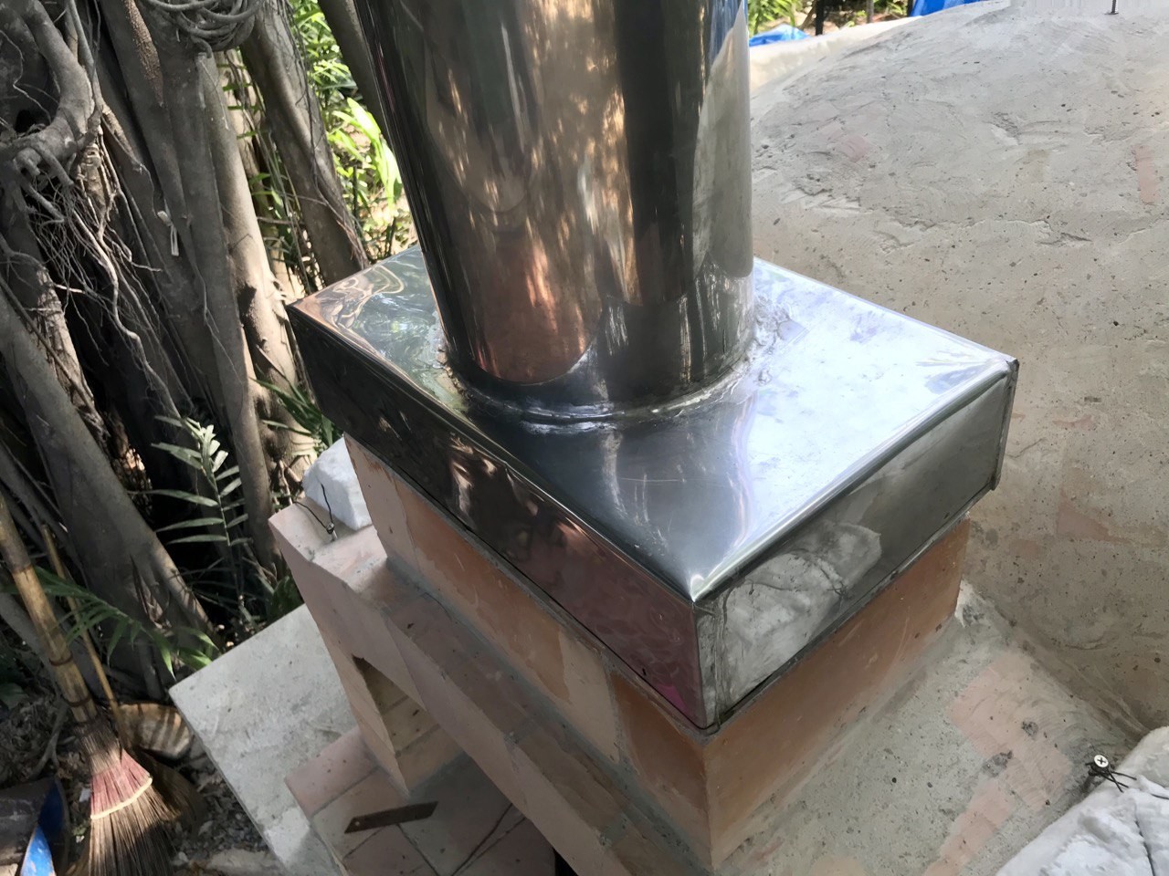

      I managed to find a metal workshop just down the road here in town (Thailand). A couple of guys came around and took measurements, and I provided a few illustrations how I wanted it, and some ceramic fiber for isolation (double barrel). I received the custom-made stainless steel chimney a few days ago and I'm really happy with the result! I reckon I got a good deal too, paid 4000 Baht for the lot ( 120 USD)!
      Some pics:
