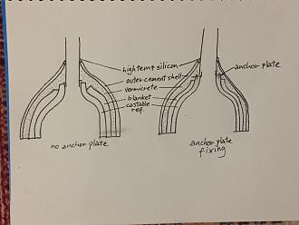

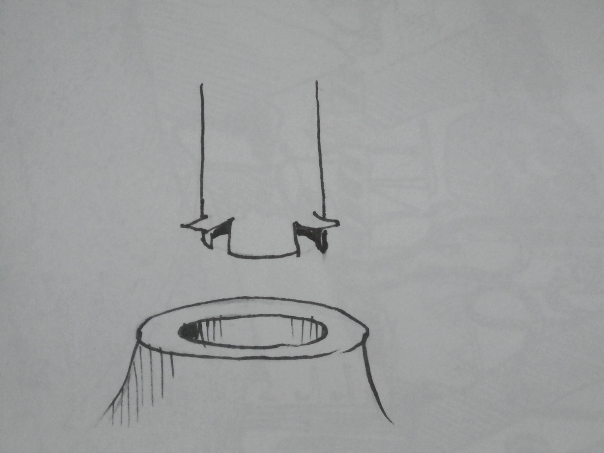

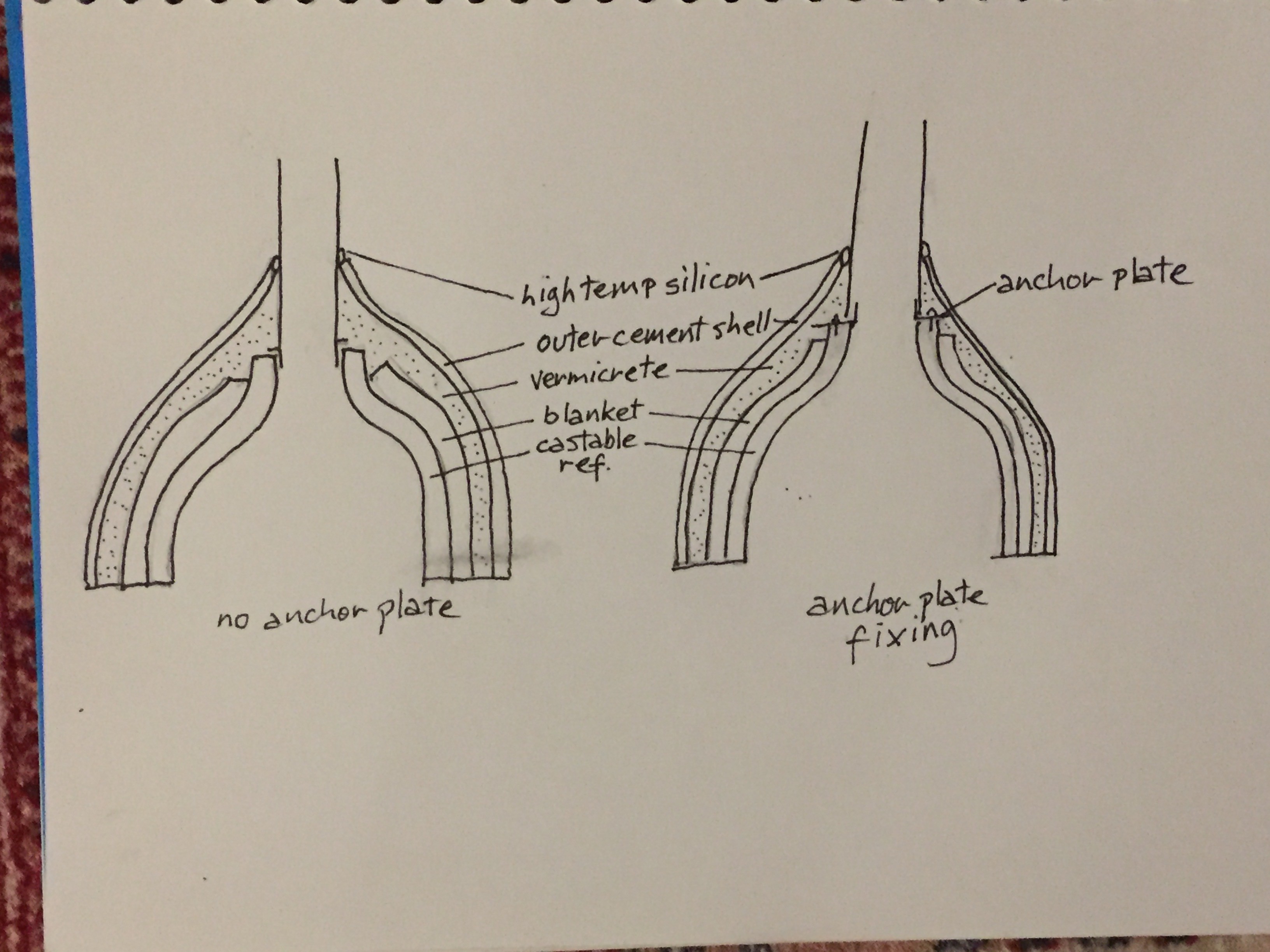

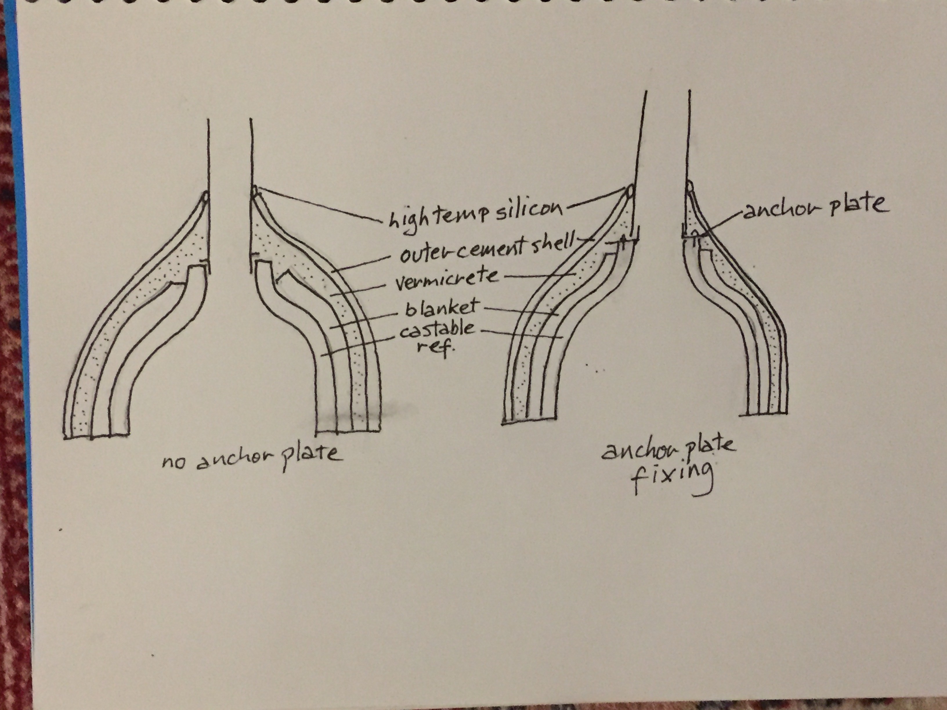

            Not sure how you plan to attach the pipe to the gallery, but I don't use an anchor plate because a. they are ridiculously expensive. b. they take up too much space at the top of your gallery and c. they require fixing by drilling and fixings which create potential crack issues and corrosion problems. On the second two ovens I built I cracked the flue gallery castings because I cast right up to the pipe and the resulting expansion of the far more conductive ss pipe well before the refractory that surrounded it had time to also expand. I now ensure that the pipe is a slightly loose fit and pack around the joint with some6:1 vermicrete which has some elasticity to it. The attached pics may help you.
            There is also a similar problem where the outer render meets the pipe. If you wrap some cardboard around the pipe before rendering up to it, when it has firmed up after 24 hrs it can be removed leaving a space that can be filled with high temp silicone. This will prevent cracking and a n entry point for water.

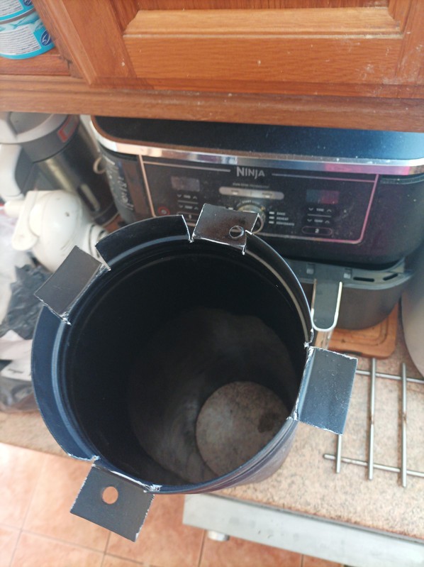

                          Originally posted by david s
                          Click image for larger version Name:	IMG_0490.jpeg Views:	0 Size:	786.8 KB ID:	446662 Click image for larger version Name:	P2160559.jpg Views:	0 Size:	244.1 KB ID:	446663
                          Can you explain a bit about how the bottom of the flue is making contact with the cast? Are they just flaps that you've cut and bent outwards?
                          My flue is 6" in diameter but the bottom has a 2" long section that's a tiny bit narrower (by 1mm), allowing the pipe to sit on the rim of a 6" hole.
                          As the pipe will be a loose fit (i.e it's not firmly cast/locked in place) will that mitigate possibility of cracking as a result of the steel expanding and contracting against the casting? Or do you recommend I do what I assume the diagram illustrates - keeping contact between the steel and cast to a minimum with just a few flaps resting on the rim while the vermicrete is added?​

                            #14
                            Yes your reasoning is correct. The second two ovens I built both cracked the gallery casting. For both builds I cast the gallery directly against the flue pipe. I believe that the cause was the expanding stainless pipe.(in both cases the pipes were custom made using 0.9 mm thick stainless rather than the usual 0.5 and this would obviously have more expansion power) Ever since I have always made the castings slightly loose (about 3mm bigger diameter than the pipe). This can be easily achieved by wrapping 1.5 mm thick cardboard around the pipe and then also wrap some plastic around the cardboard so the pipe can be easily removed. I call this the “withdrawal method”
                            The three tabs as illustrated work well to hold the base in place as well as adjusting for pipe vertical levelling, although I now find 4 tabs makes the job even easier.
                            The other drawing shows how the outer shell supports the pipe higher up. The higher you go, the greater the stability. A 3mm gap to be filled later with high temp silicone, again can be created using the cardboard around the pipe trick.
                            PS Most builders use an anchor plate, but because they are expensive and take up a lot of real estate, I think this method is far superior. Also fixing by drilling into the casting, which is the usual method introduces some additional problems of, corrosion of the fixings, expansion/contraction loosening the fixings, or their expansion cracking the casting.

                              Just cut out a few flaps in the pipe.
                              Yes this is definitely the better design compared to the use of an anchor plate. There are steel sheets you can buy which resist high temperatures (310 grade I think it's called) - but it's expensive as you say, plus you need the appropriate drill bit for the hole as a further expense. Then the possible corrosion of the fixings...can you actually buy masonry screws which resist those temps...not sure.
