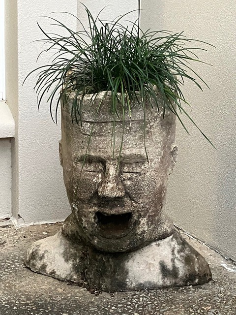

Interesting that you mention Michelangelo. Regarding vermicrete, it can be used to create an excellent material, suitable to carve, because it's so easy to adjust its strength. As an ex-secondary school art teacher I've had students carving lots of these, yes the water drains out the mouth. The vermicrete is easy to both carve and add on other bits to build up.
Michelangelo also used to describe his MO as "I am releasing the figure from imprisonment".
