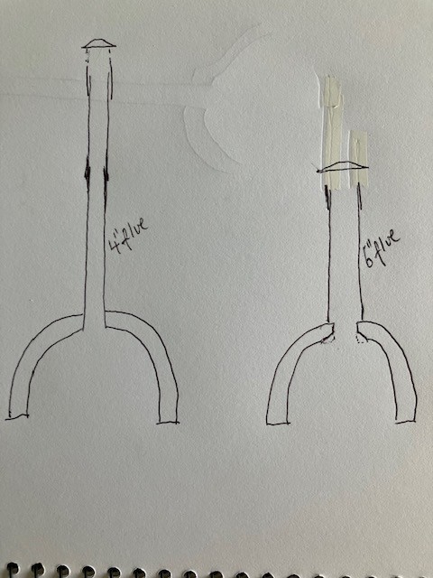

    A 4” flue is definitely inadequate for a 32” oven, you need a 6” one. My ovens are only 21” and work well with a 5” flue. Area for a 4” = 12.5 sq in
    5” = 20 sq in
    6” = 28 sq in
    Making the flue taller does increase the draw but the effect is far more powerful by increasing the diameter and therefore the cross sectional area.
    There is another type of cap called an anti downdraft cap, but I doubt it will reduce constriction. You could try extending the legs on the China hat to make it taller.
    Really the better option would be to replace the 4” pipe with a 6” one and attack the entry to it with a diamond blade to improve flow. You will still have a restriction at the pipe entry but the extra draw from the larger diameter pipe should be adequate to overcome it. It will act like a venturi at that point with smoke accelerating there. You should find the extra height is not required, which also eliminates the need for stays to stabilise the extra height.

      Hello david and thx for the Quick reply and the illustration, its appriciated.
      Will start with extending High of cap, then on to anglegrinder… not much room inside the mouth though. I need to buy a less ugly flue anyway, so i might as Well go up to 6 inches. I expect to still need about same height so that the smoke still clears neightbour roof.
