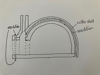

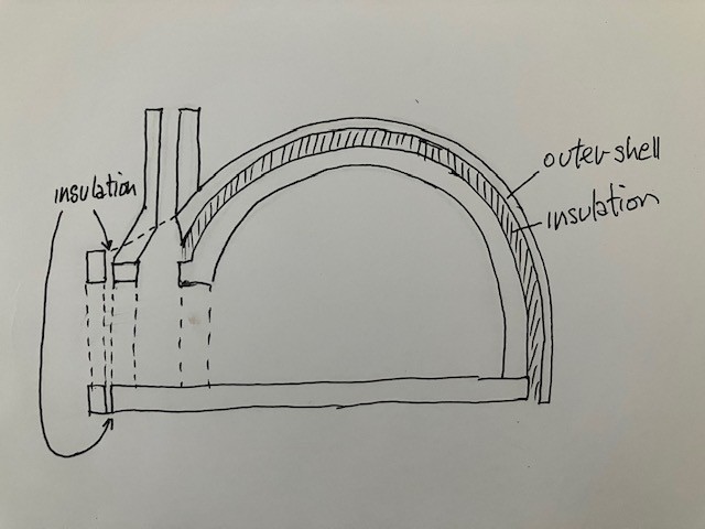

                I was envisioning something like this with the gallery also surrounded by insulation
