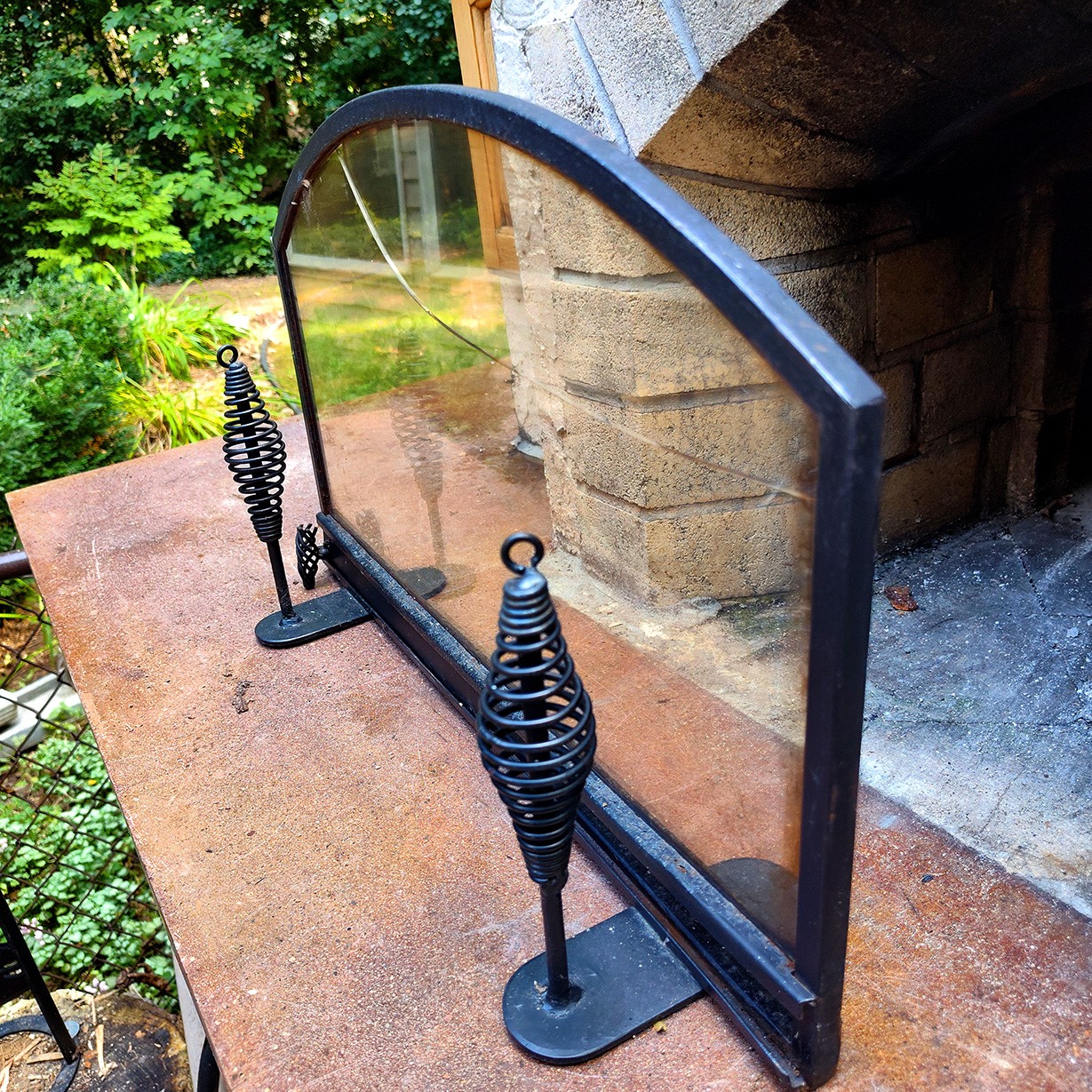

                        Well, after 16 years of use, the glass in my "door with a view" has cracked. However, not because of thermal expansion issues, the glass exceeded all expectations in that regard (cleaning soot off of 850-degree glass with cold-water-drenched towel). The problem came down to careless handling. Regardless, it brought me back to this post to see if I had mentioned where I ordered the glass from. And I did (onedayglass) Not surprising, price went up ($115 to $150) but not bad over the course of 16 years (CAGR of only 1.84 pct per yr) and still well worth it for the utility I have gotten from this door over, now, the better part of two decades.
                        Note that the drenched towel stress test referenced above was to clear the glass in the middle of a bake, a practice I abandoned after I discovered the tip provided to exceloven below.
                        Jim

                          Very nice. Would you consider double glazing like conventional kitchen ovens, to get the insulation benefit?
