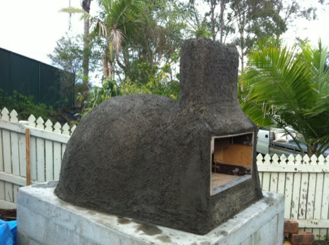

Spoke to a bloke last week by phone...Brother of a friend who is casting an oven shell over a sand mold. He is using a mix of Ciment fondu and crusher dust.
Crusher dust is basically the small washed particles.. dust and up to sand grain size left over from washing gravel for road ways. Road base is another term I heard used. I have used road base to pack down a base under pavers...add a litle cement powder water a wack down and its like cement..and very stable.
My question...could crusher dust be used as a substitute for the fired component...the fire clay in the home brew fire proof mortar mix. Its crushed basalt fired in the earth not just a kiln so on the temp stakes that should be enough?
Any thoughts
Regards Dave
PS this blokes ovens now has under hearth pealite insulation plans a fire brick hearth and is to have ceramic insulation over the dome so in all other aspects should be a worker
