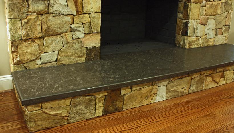

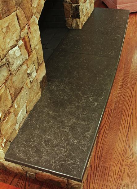

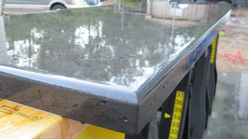

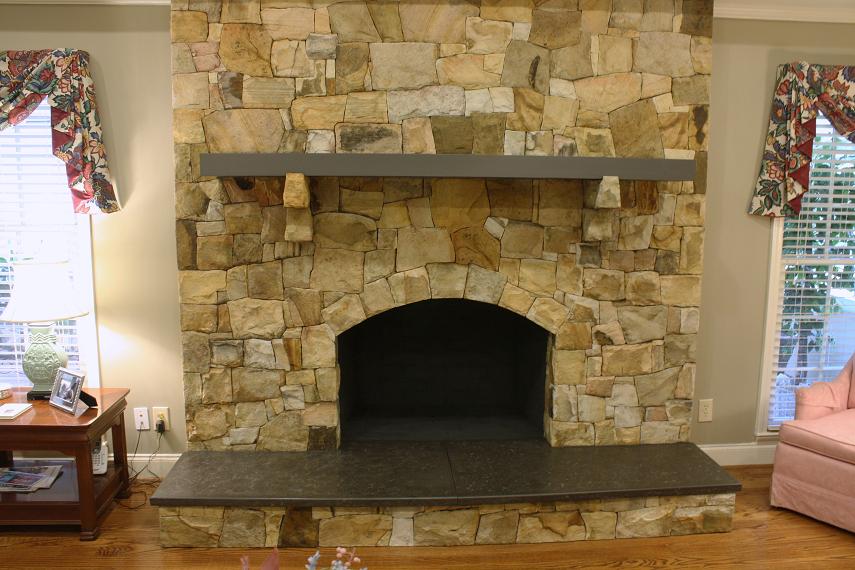

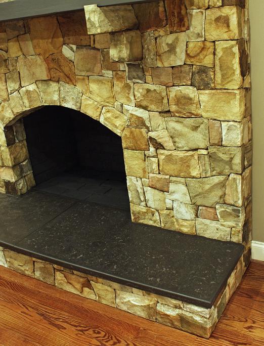

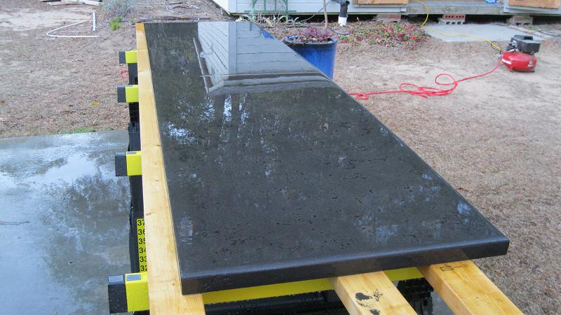

  • stonecutter
    replied
    Re: Home brew concrete and cast-in-place concrete.
    Close up of the profiled edge and a some of the finished product.
Name:	second half4a.jpg
Name:	second half6a.jpg
