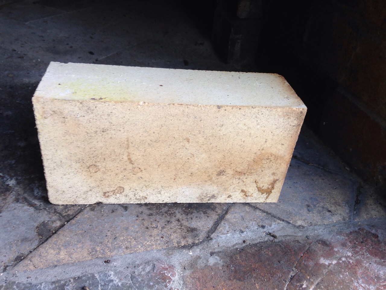

The other alternative is this ad on gumtree.
PIZZA OVEN BRICKS | Building Materials | Gumtree Australia Swan Area - Midland | 1070856803
The seller claims they are new although the pictures don't look like they are but he can't tell me whether they are light, medium or heavy duty. Are these worth the risk?
