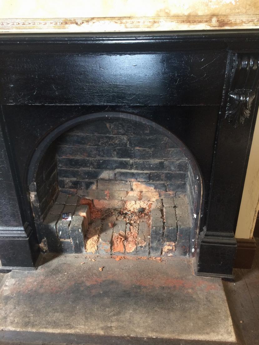

          Here's a good example of why you should use fire bricks. In this case these solid reds were not up to the task. Click image for larger version
