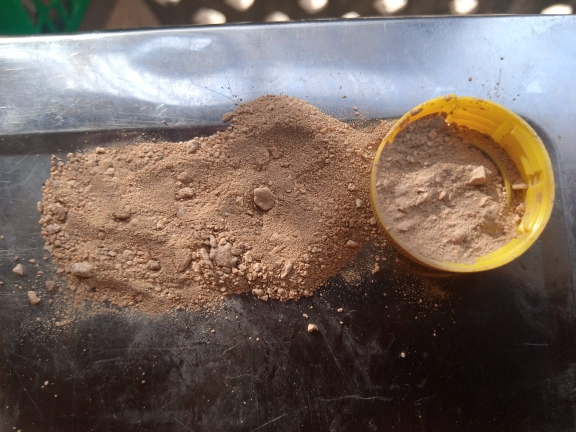

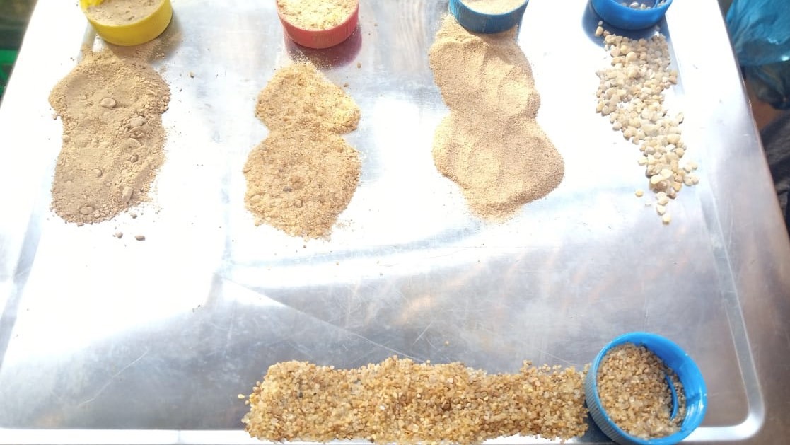

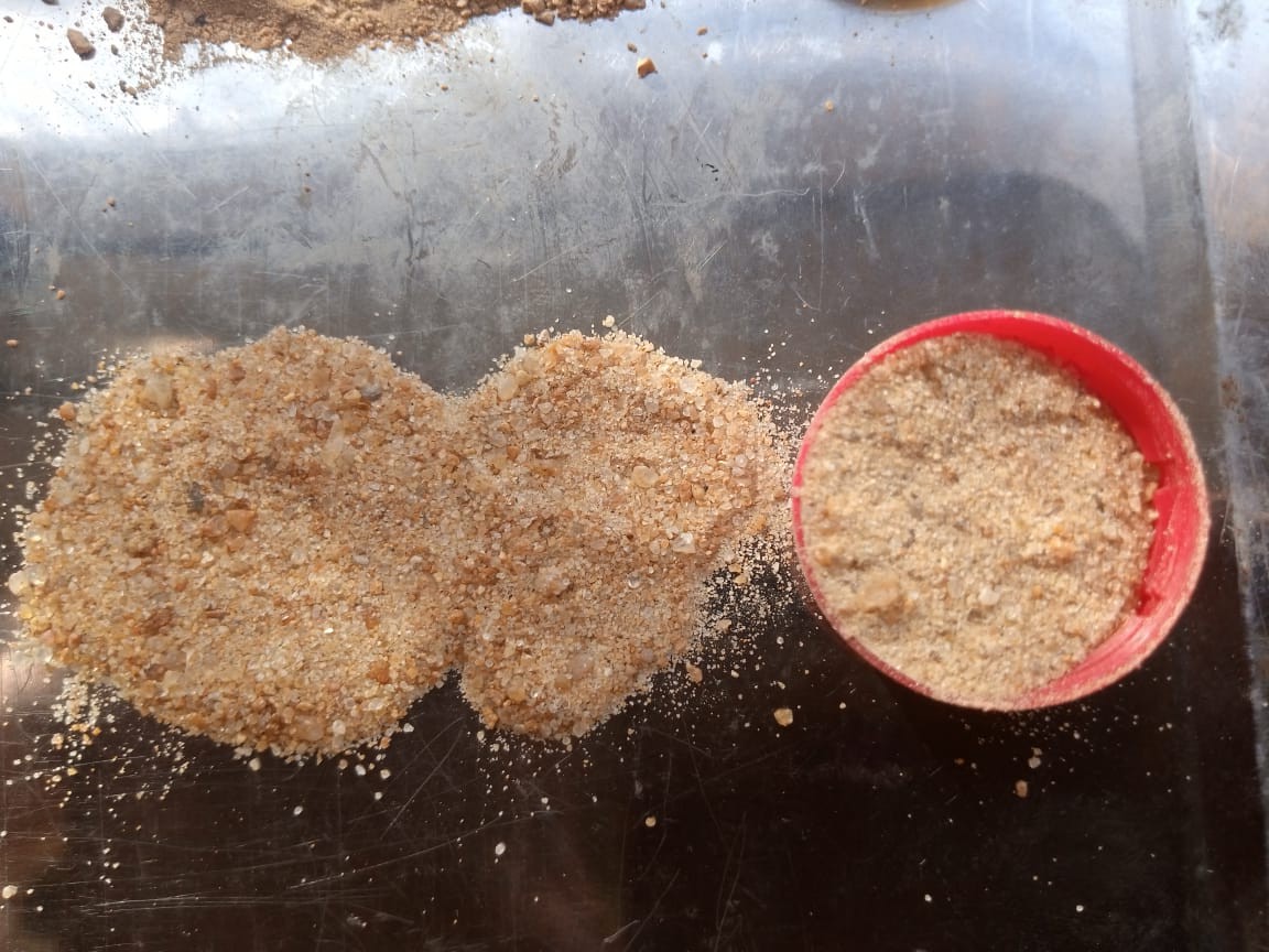

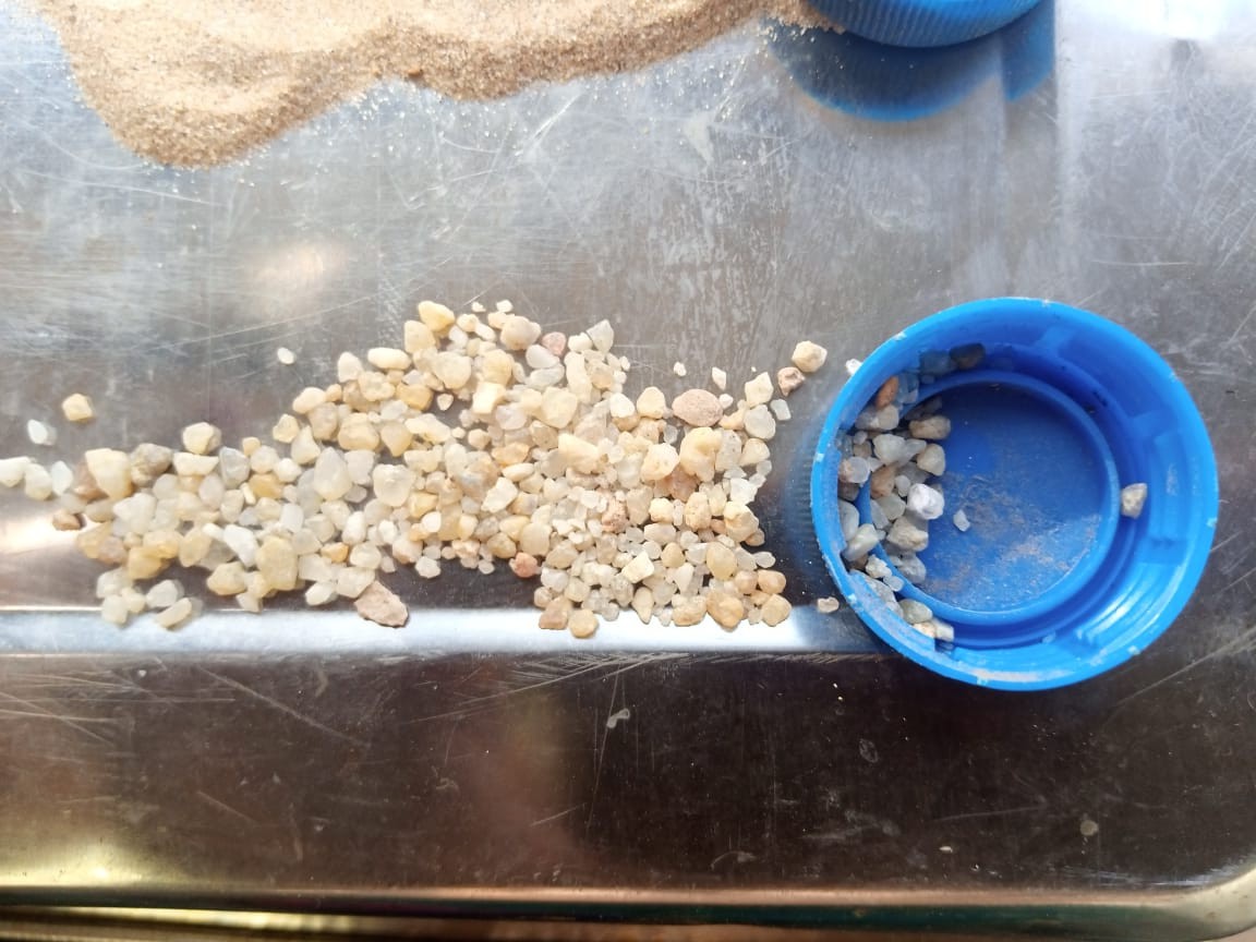

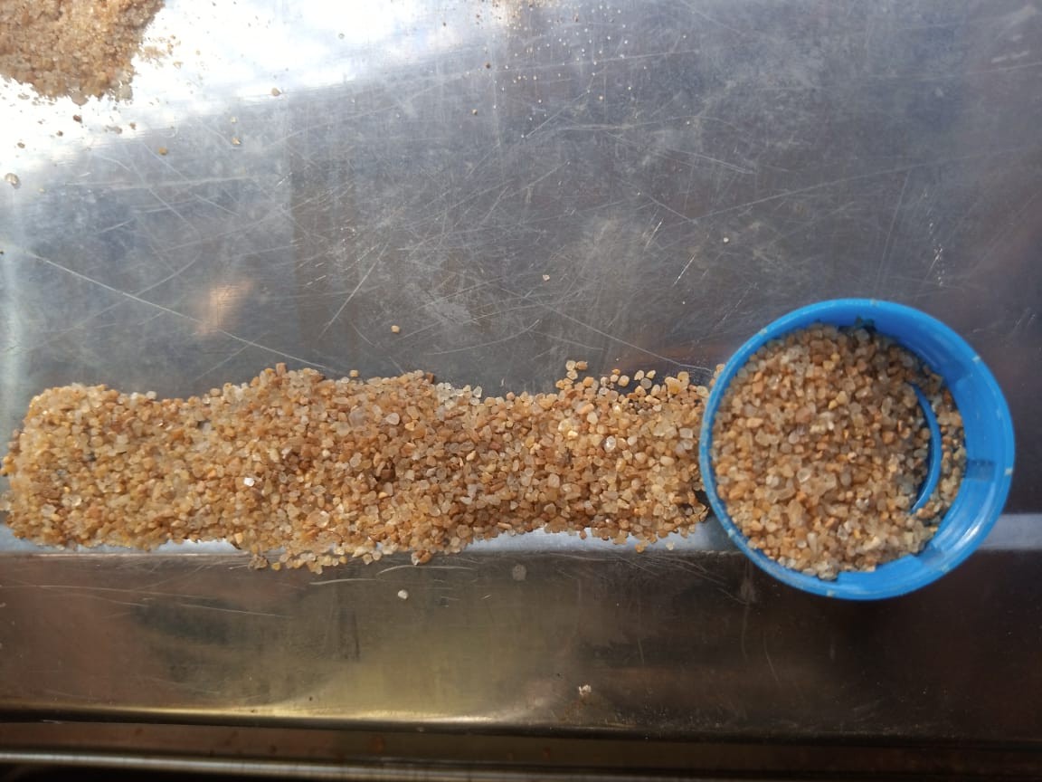

        Help me choose what sand to use
        So went out to look at what sand I can get and each of the places I have checked has a different stash. I can get sand like this from close my place:
        Click image for larger version  Name:	sands bright.jpeg Views:	0 Size:	140.4 KB ID:	436992
        Closeup of mix 1:
        Closeup of mix 2
        Click image for larger version  Name:	mix 2.jpeg Views:	0 Size:	206.6 KB ID:	436995
        Closeup of mix 2 filtered through 2 meshes, [ don't plan to use this mix - very expensive because of labor]
        Click image for larger version  Name:	mix 3 mesh filtered.jpeg Views:	0 Size:	163.1 KB ID:	436996
        Silica 2mm:
        Click image for larger version  Name:	silica 2mm.jpeg Views:	0 Size:	167.5 KB ID:	436997
        Silica sand:
        Click image for larger version  Name:	silica sand.jpeg Views:	0 Size:	194.2 KB ID:	436998
        Should i keep looking for better sand? I don't mind checking out a few other spots but then I will have to head out to more than a few blocks from my place. What do ya guys think?

          You should use the sand that gives the highest packning. It will be the strongest. Guess/suggestion: Remove the fines and coarse above 1 mm. Too fine particles causes shrinkage due to exessive water absorption.

                A mix of grain size is actually the best, but don't use anything much bigger than around 2mm. the finer sand will produce a more workable mix than coarser stuff. With the high proportion of clay in the home-brew mix it is more than enough to make pretty much any aggregate in the mix nicely workable. Just from appearance, and it's a bit hard to tell just by looking at the pics, but I'd say the yellow bucket would be my pick.
                • #9
                  those are not buckets,
                  those are soda bottle caps holding the samples.. maybe that gives the perspective of the pics a better point of reference. But I think i get you. Once upon a time I cracked open a firebrick and saw inside, that it is made of fine, course and some in the middle kind of grain sizes.
