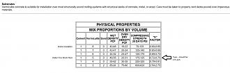

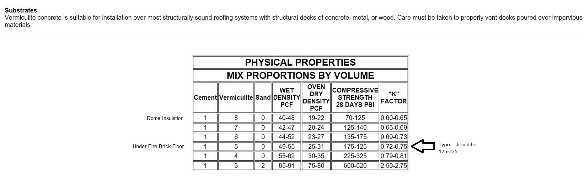

              A couple other options, AiSi board will work as well, similar to CaSi. Here are a couple key components in addition to a high temp rating, 70-75 psia compression at 5% compression and a K value of about 0.55 Btu-in/(hr*ft2*F) at 500 F. If budget is a factor, a 5 to 1 p/vcrete is an option you just need twice the thickness of CaSi or AiSi. Min recommended floor thickness for CaSi or AiSi is 50mm. FoamGlas is a good first layer since it will not absorb water but it is hard to find. There are new perlite based boards with good thermal/structural properties and water resistance but I have not used them.
              Click image for larger version  Name:	Vcrete K values.JPG Views:	0 Size:	159.3 KB ID:	441763
