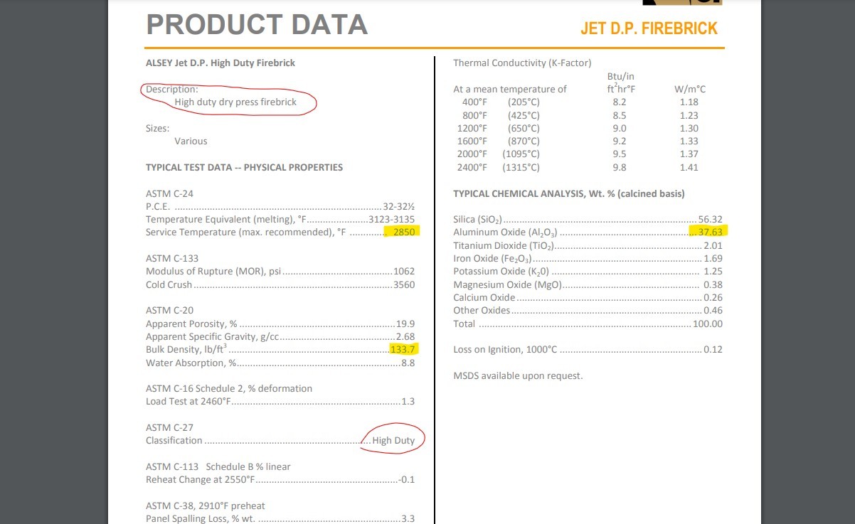

                Hi Everyone,
                This seemed like an appropriate topic to ask this question within. I've got some confusion as well over what brick I should use for the floor of my clay oven. After reading the posts above I'm beginning to think that the brick I can source locally would be fine. I was thrown off by the store's classification of the brick as "high-duty" and FB's recommendation of "medium-duty". Looking at the spec sheet though, the only difference between it and FB's recommendation is that the service temp is different. I'm going to post a screen shot of the spec sheet for the brick I can get locally. The other option I have to go with would need to be shipped to me and the only info that I'm given is the alumina content which is 35% and the service temp which is 2500f. Lastly the FB site, and this is where my confusion comes from, lists medium duty brick as having up to 38% alumina, 135lbs/cuft density, and service temp of 2450f. Your feedback would be much appreciated.Click image for larger version
Name:	fire brick specification.jpg

                  Some builders believe that the high duty bricks must be better because they are fired to a higher temperature. This is a fallacy because our ovens never get anywhere near those higher temperatures. In fact a low fired brick may be far more suitable because it is less vitrified, meaning a lower density and a more open body that can withstand thermal shock better. An example of this is the low fired (approx 600 C) Sth American pottery that can withstand direct heat from a stovetop where porcelain or stoneware bodies fired to far higher temperatures suffer from thermal shock destruction.
                  I would agree with FB about medium duty brick being the most suitable. There is also the issue of cutting high duty bricks which many builders report go through expensive diamond blades much faster because of their higher vitrification and density.
                  • #10
                    Agree with Dave. I used "super duty" because a got a great deal but I went through a baker's dozen of diamond blades (although cheap ones). Use what you can source locally. PS It would be better if you start you own build thread.
