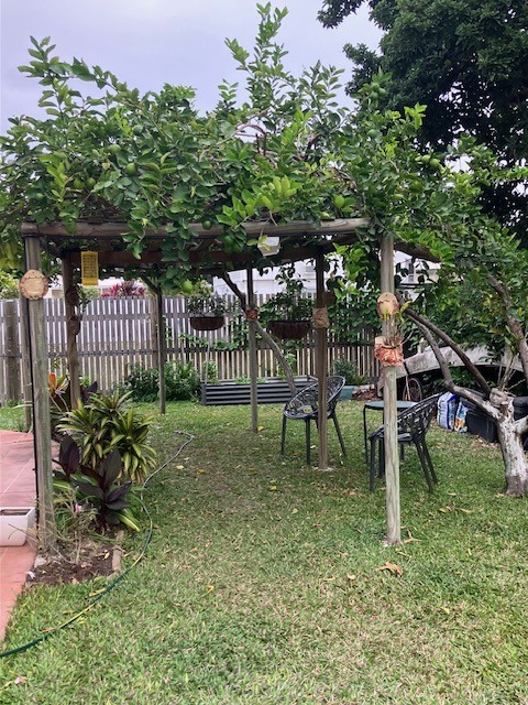

        Oh, I misinterpreted your application method. I just paint the mixture on the trunks. I didn’t realise you sprayed whole trees. I've trained my lime and lemon trees over a pergola, like they grow lemons on the Amalfi Coast.
