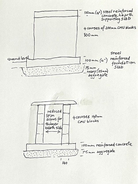

              Can you confirm the thickness of the big slate concrete being used for the top of the brick walls, 0.10??, assuming 2000 and 1000 are in mm. These ovens get really heavy and should have a min. of 4" of rebar reinforced concrete or equivalent material.
                • 9216
                I'm assuming slate=slab
                The preparation for foundations depends on climate, soil type and depth, slope, if any and weight it has to support. If in doubt consult a local building professional, but
                the usual build procedure followed by most here is a 100mm (4") concrete steel reinforced foundation slab on grade, over compacted aggregate, followed by 4 courses of concrete masonry unit CMU blocks with their cores filled, (go another half height block course if you want it higher if you're tall). Topped off with a 100 mm (4") concrete steel reinforced hearth supporting slab.
                This alone is considerably weighty. Because my ovens are small there is less weight to support than a larger oven so I've reduced the CMU blocks to two piers only and reduced the selection of their width to 140 mm (6") This has the additional advantage of being open at both ends providing airflow into the wood storage area. A cantilevered slab, whilst requiring more complex formwork, also provides a more weatherproof cover for the wood storage area underneath. Dry wood is essential. The reduced span of the stand also allows for a thinner hearth slab reducing weight, materials, labour and cost even further. (See second drawing) But be aware that the strength of any concrete slab is proportional to the square of its thickness. ie a 2" concrete slab whilst being half the thickness and weight of a 4" one, is only 1/4 of its strength.

                    I think I know what you mean but how about drawing a little hand sketch similar to what David did so we can be sure of your base, wall, hearth concept.

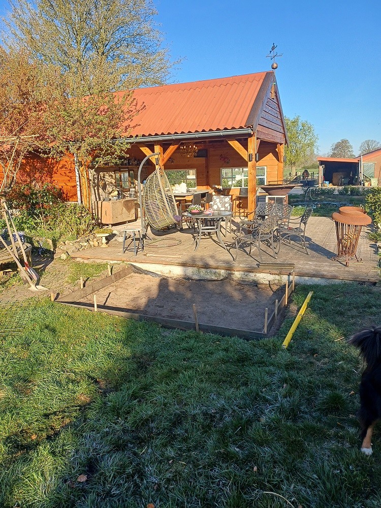

                              This is the place that it will be build. Click image for larger version
                              I will drill some rebar in the foudation of the deck, just for security. minimum thickness is 13cm
