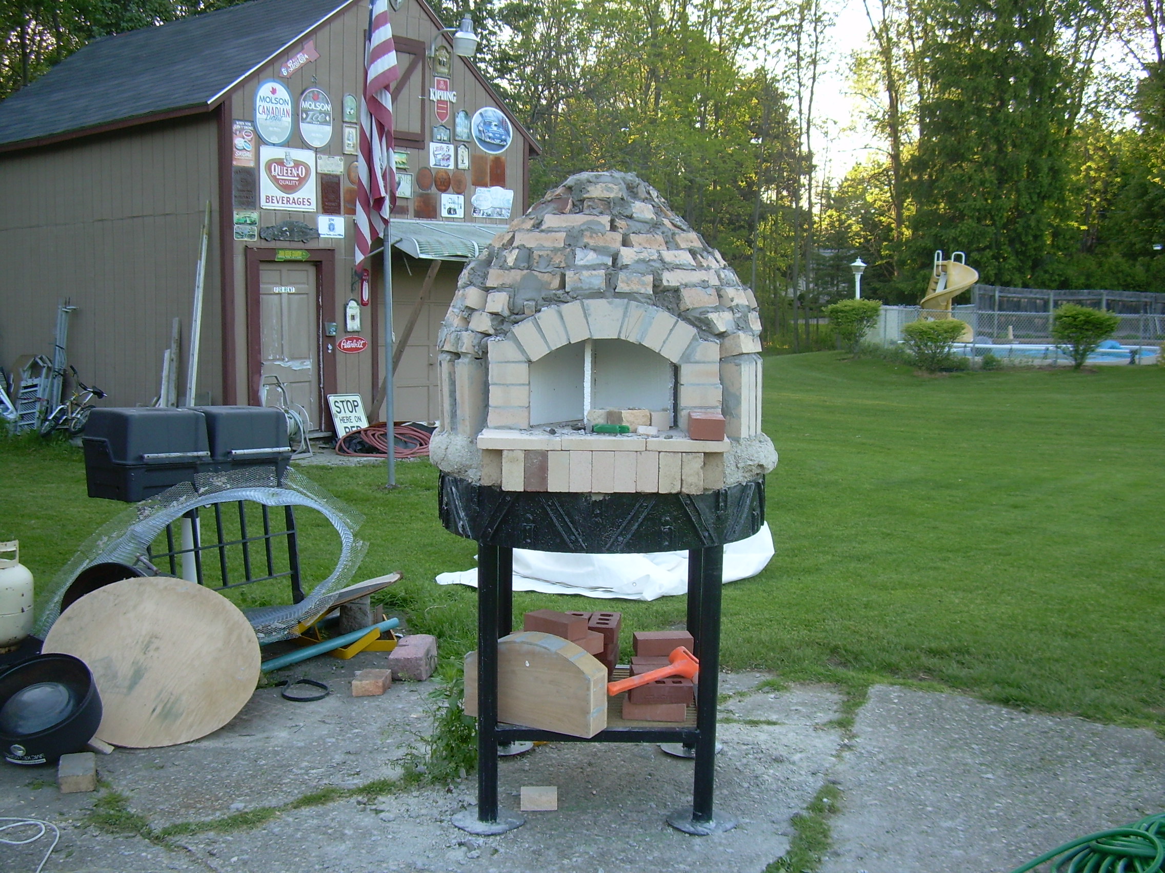

    concrete over the fire brick dome
    do you have to use the refractory morter over top of bricks or can you use portland cement for this. Then put the vermiculite insulation on then the stucco. Click image for larger version

    Re: concrete over the fire brick dome
