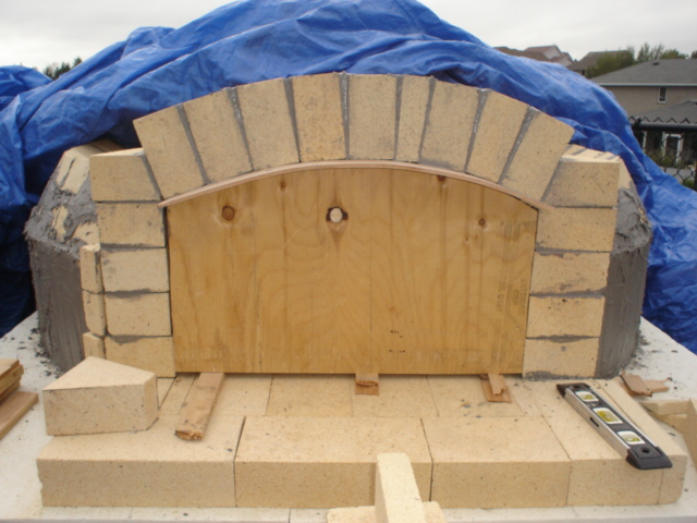

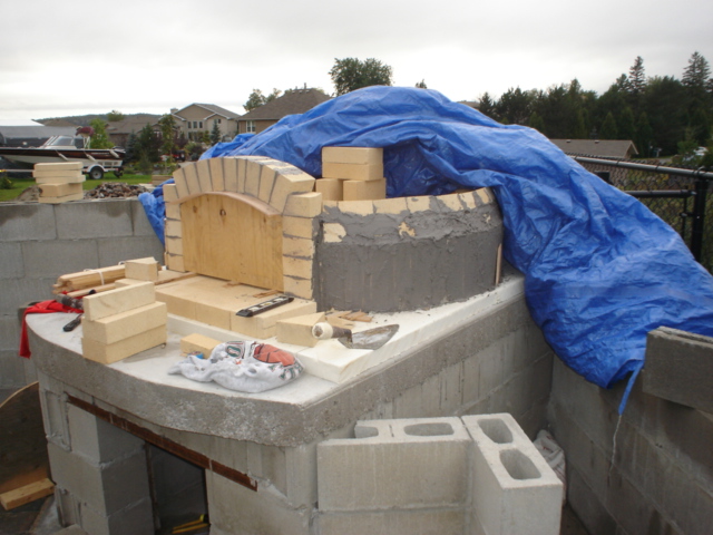

              I agree, 1/2" just does not cut it. If your bricks are not flush on your oven floor don't worry as you can grind them flush. If the floor is not yet installed you can use a mix of fine sand and fire clay with no cement and use a tile knotched trowl then set your brick like laying tile. I recomend reading the PDF for building a pompeii oven several times as each time I read it, I discover a new detail that I missed before. Cheers, Here are a few pics of where I'm at.
