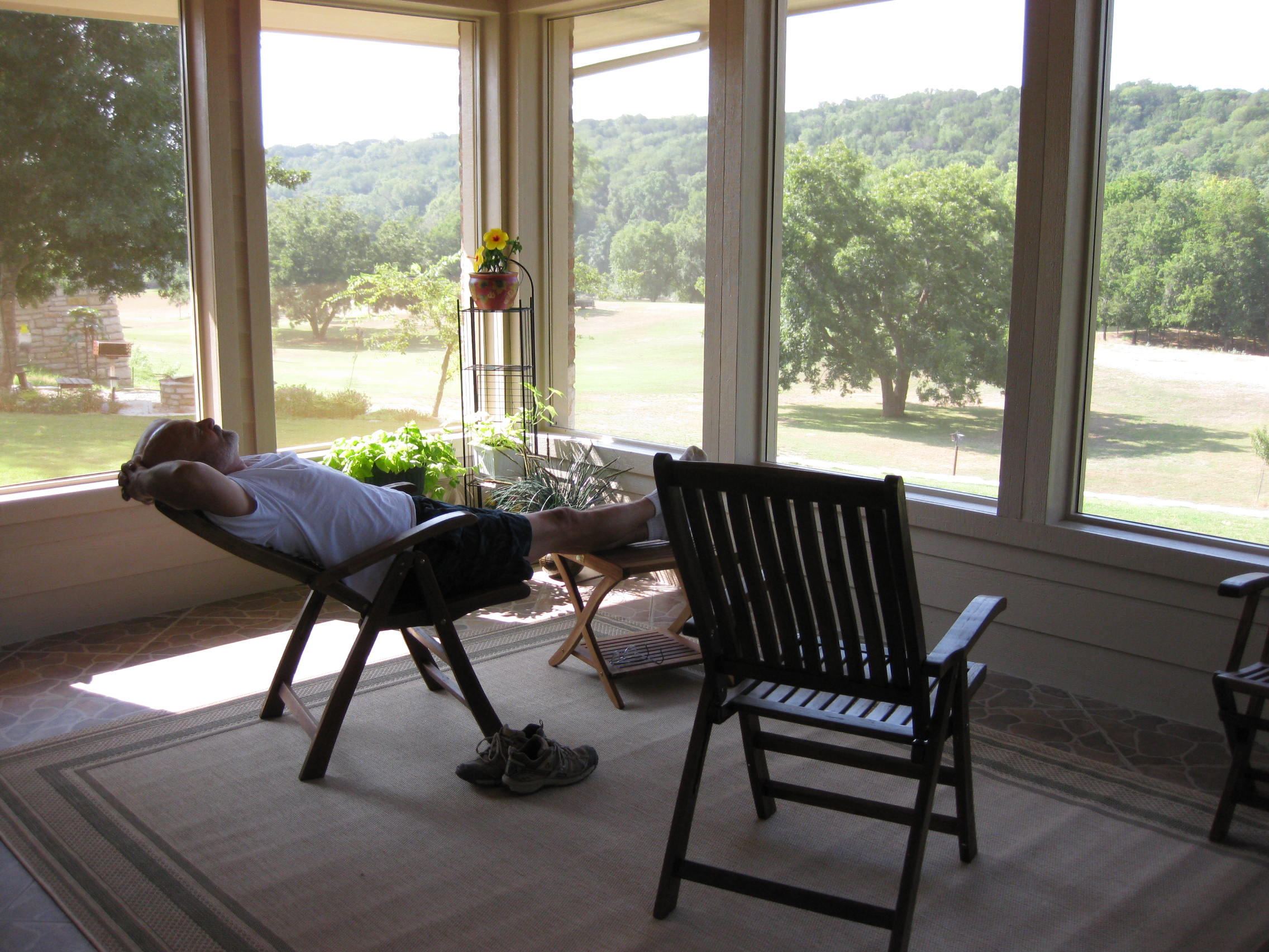

              You are asking for input and I think that is a good idea. I certainly understand about flies. We have the same problem and made a screened porch to keep them away. In the planning stage, that room grew in dimension and even got a second floor and a balcony added above. All-in-all, it was a very good addition to the enjoyment of our home.
