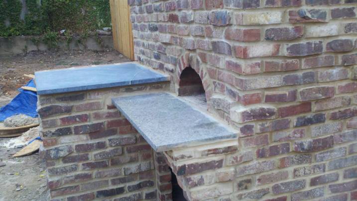

    Today I am having a piece of soap stone cut (at stone source a local store) for my work area on top of the fire pit (36"x38"). I also am having doors built out of blackiron for the fire pit door (18'x18") and the smokehouse door (72"x24"). The oven is getting its third row of bricks and the front arch looks great.
    Any suggestions or comments would be great.

      day seven and eight: The oven is finished and now being insulated. The smokehouse has a chimney now and is ready for the door. I shot a picture of the vent from the fire pit to the smokehouse.
      I picked up my soap stone work top at Stone Source, and it looks great. It is one of the last things to go on. Looking for a simple roof. Tin is what I think I will go with... kind of running low on funds.. any ideas for a reasonable roof?

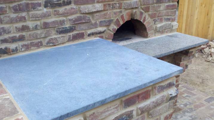

        storm hurt the progress of the oven... set the soap stone and the rough cut granite in a couple of days ago.....

                          Things have slowed down a little bit. Got the door mounted for the smoke house. Tested it out, the smoke draws great and the house hold heat. Also the roof is taking shape. Next week I am on vacation and I am going to play in the backyard.
                          Here are some updated pictures.
