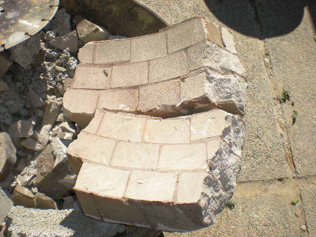

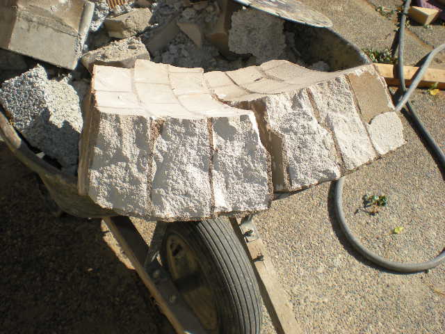

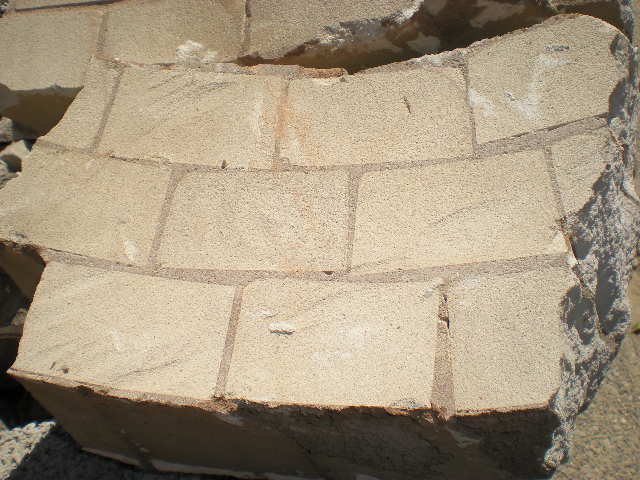

          I would like to recommend strongly against using brick that had gone through freeze thaw cycles. I know Minnesota winters are much more severe than other parts of the country/world.
          But here is my experience, I was able to acquire 700 free fire bricks that had been used in a fireplace and had been piled in a backyard for several years going through a number of harsh winters.
          The bricks were left uncovered and when I acquired them I moved them to my backyard and also left them out in the weather. When I finally decided to build the oven I built it out of these bricks that had gone through the freeze thaw cycles.
          As you can see from the photos results were quite drastic. My mortar joints remained solid, but the bricks cracked through and caused enough structural issues to the dome that I decided to tear down and start over again.
          I would highly recommend you not use bricks that have been through a freeze thaw cycle or at least as many as my bricks had experienced.

            I do not see any damage on those bricks indicative of freeze-thaw. Freeze-thaw damage will be spalling or even entire faces popping off, not cracking.
            As a rule, brick stored outside in any weather will not suffer from the effects of freeze-thaw, even though they may be damaged by the same conditions once laid.

                The reason you do not see any spalling or faces popped off is because these bricks were cut down to only use what appeared to be the good parts. I have no other explanation other than freeze thaw to explain what happened to them.
                I started with 700+ bricks, I only had 150 left at the end of the dome and many times only got one usable piece out of a brick due to surface imperfections (I guess you could call it spalling) or chips.
                Your mileage may vary... I am just saying I would not use firebrick stored outside on another oven. It was hard enough building it the first time. but I did get better at cutting and laying the bricks for the second version.
