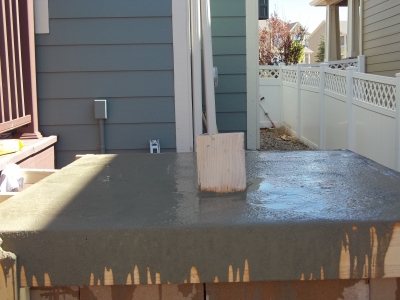

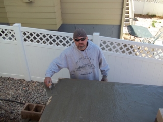

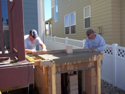

    So This past weekend we poured the structural hearth. FB boards arrived as well as the Ceramic Blanket. Measured the interior oven space ,minus the width of the bricks on each side and have a 32" interior circumference..I hope I don't sound really silly now but I need someone to clarify how I will come to an 18"
    dome height when constructing the courses, is there a formula to use?
    I am attatching some build pics!

        What is the board in the center for?
        • Coloradoredusa
          • Mar 2012
          • 88
          Re: New Progress
          Its not in the center .. its an ash drop....my oven is smaller than others..it will be mre at the front of the oven
