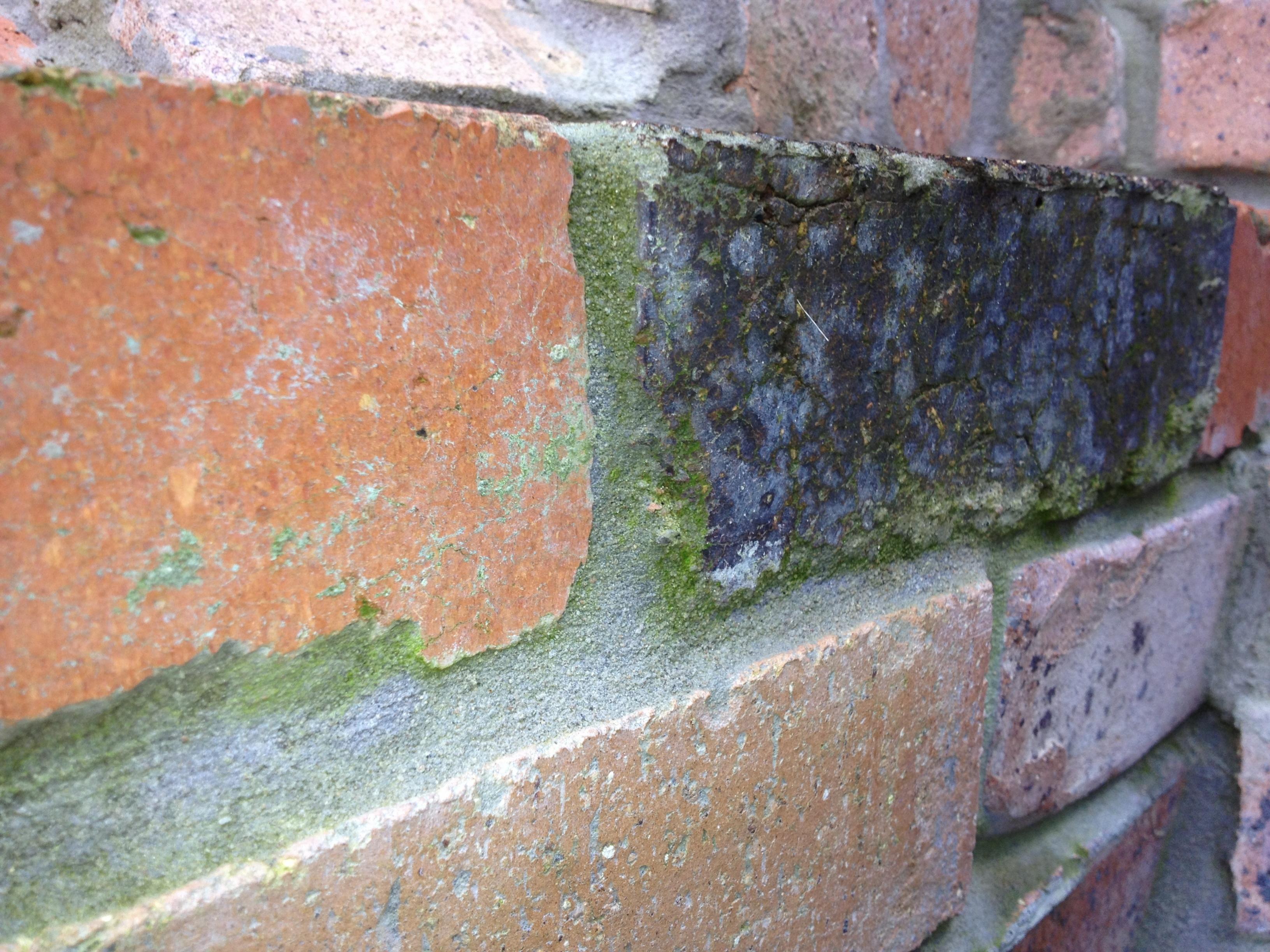

    Don't need to wish you luck, with all your hard work you have made your own luck it seems. I think you have done well in curing your oven in the wet conditions you have had. It's rained here as well, not a week had gone by since Feb without rain. Ovens dry inside but the outer brickwork is damp. And you can't seal it till its dry off course. I attach a photo it's starting to grown moss so you see what I mean.
