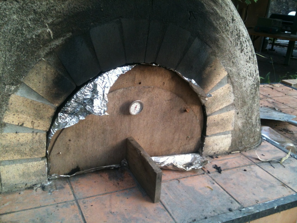

    If you are determined to have a rectangular entrance so be it. I have one and the metal expands and I have hairline cracks in the mortar not the brick. The oven cools and they disappear.
    Notice that you have had no comment on the stand. I would have core filled it myself. And it's easy to do mix up sloppy concrete in a bucket and pore it in. Doesn't even take much concrete either. If you can't do this at this stage I suppose time will tell. But there is a few positives. The forno stand is massively overbuilt to start with. You have only 3 block height and the structure is quite squat. You have a stable base and will be putting 160 odd bricks on top to pin it down.
    I think you can leave the entrance at this stage especially as you have the set back to build it later. There are ovens with no chimneys I have a friend with one you do have to put up with a face full of smoke on occasions though.

            Regards sailor vs soldier.....neither .... Start it on a row of 1/2 bricks build on the hearth you can't go wrong. It's a big oven a 36 in ,so the angle of the wall means that it should interfere with anything in the oven!
            If you look on the left you see the top of the square entry and those transition brick cuts that is probably the hardest part of the oven I think. I think those four bricks would be just as hard for an arch as a flat topped entrance!
