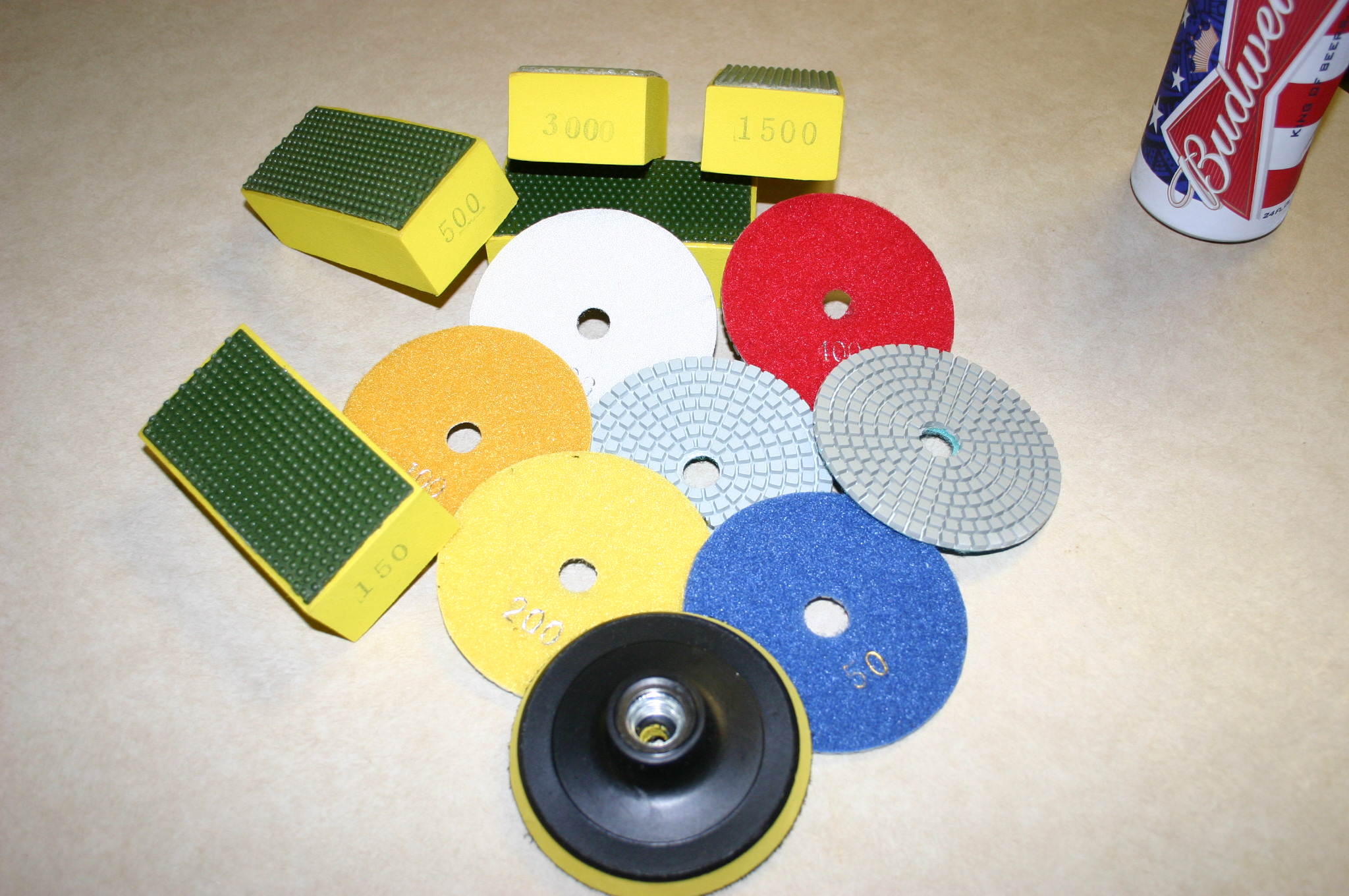

                You can place some slurry mix (portland and very fine sand) in any of the "spider holes" now while it is still green and smooth those down with a stiff sponge. A few hours later, you can use a fine grit automotive wet sand paper and water to simi-polish. Even later, you might get away with using some acylic fortifier to give it a shine.
                If you are looking for a glistening polished effect, you may have to spring for some diamond polishing pads for that curved area.
                They are the rectangular blocks in the pic. They are diamond coated sponge pads. I got mine off ebay. I think that Stoncutter recomended them or something similar for the curved areas. They did work great for the curved areas of my polished concrete.
