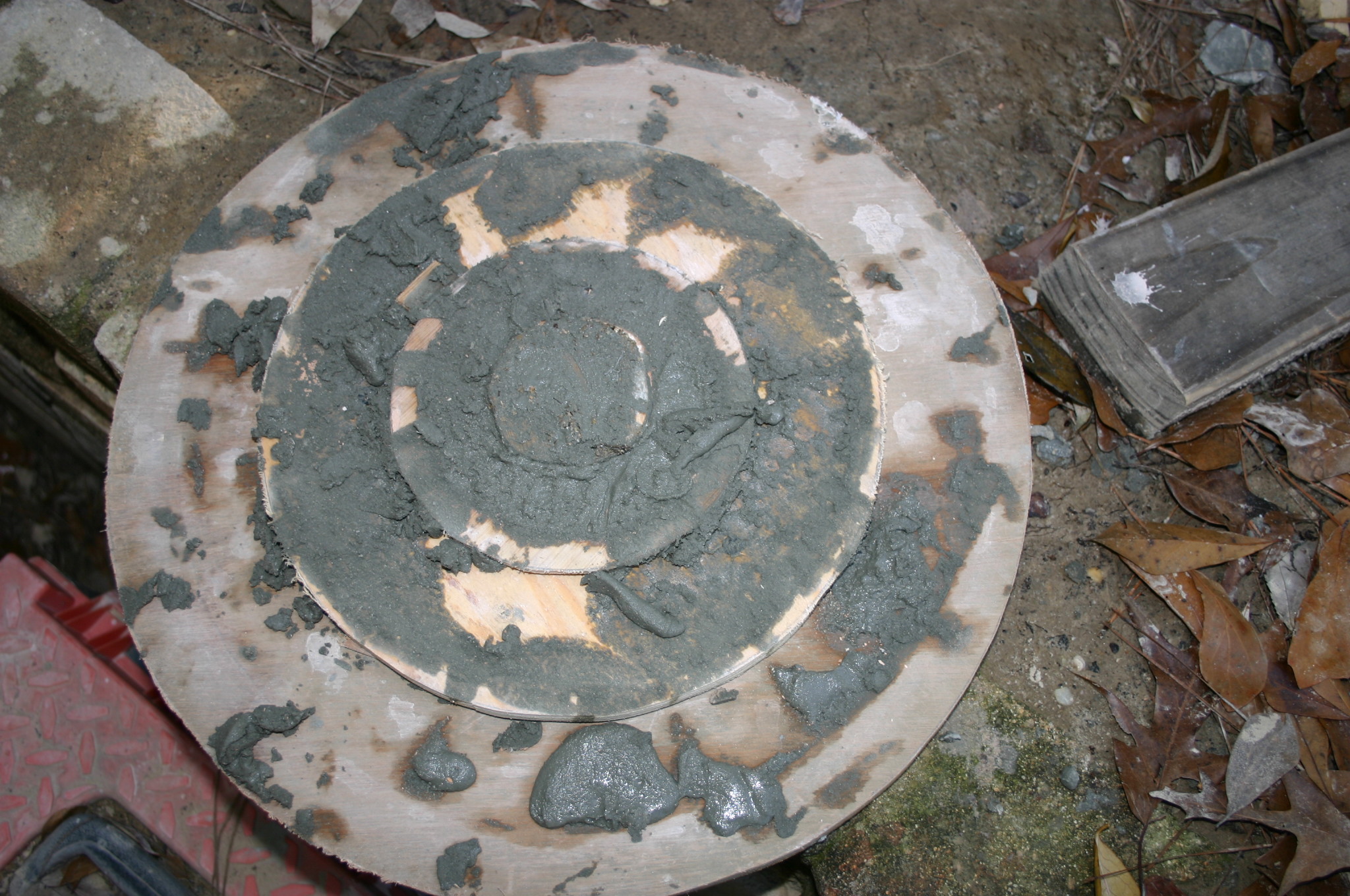

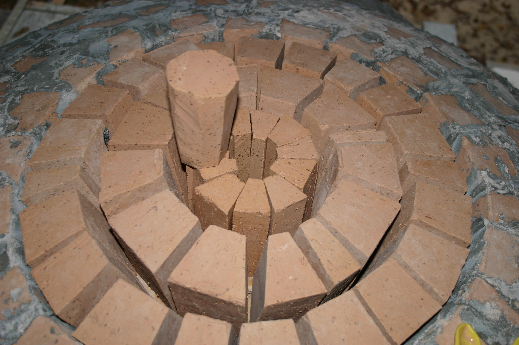

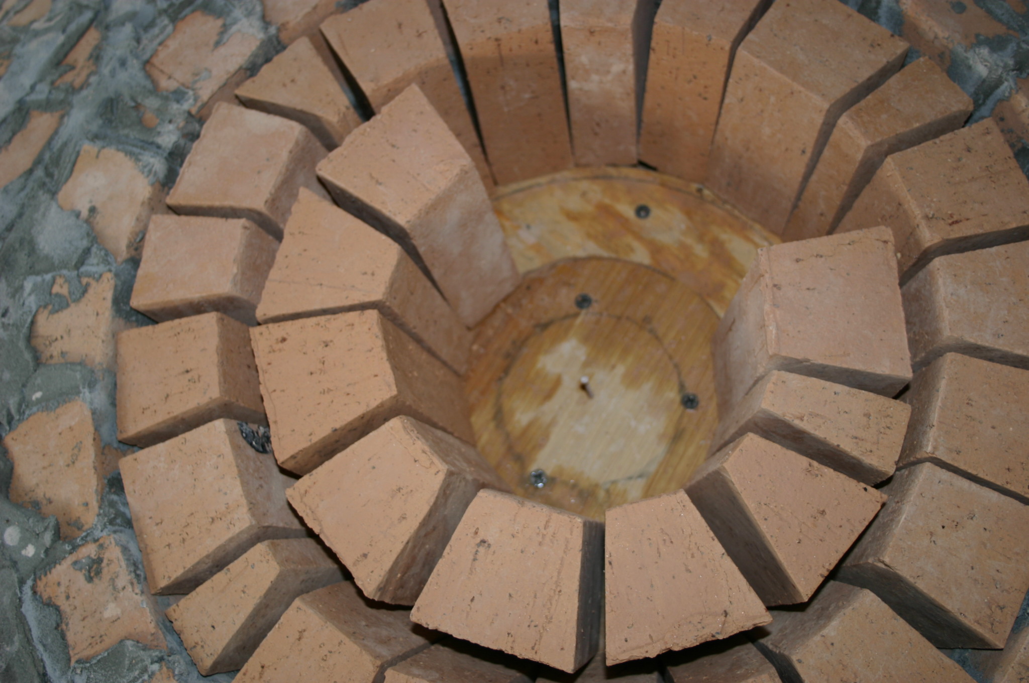

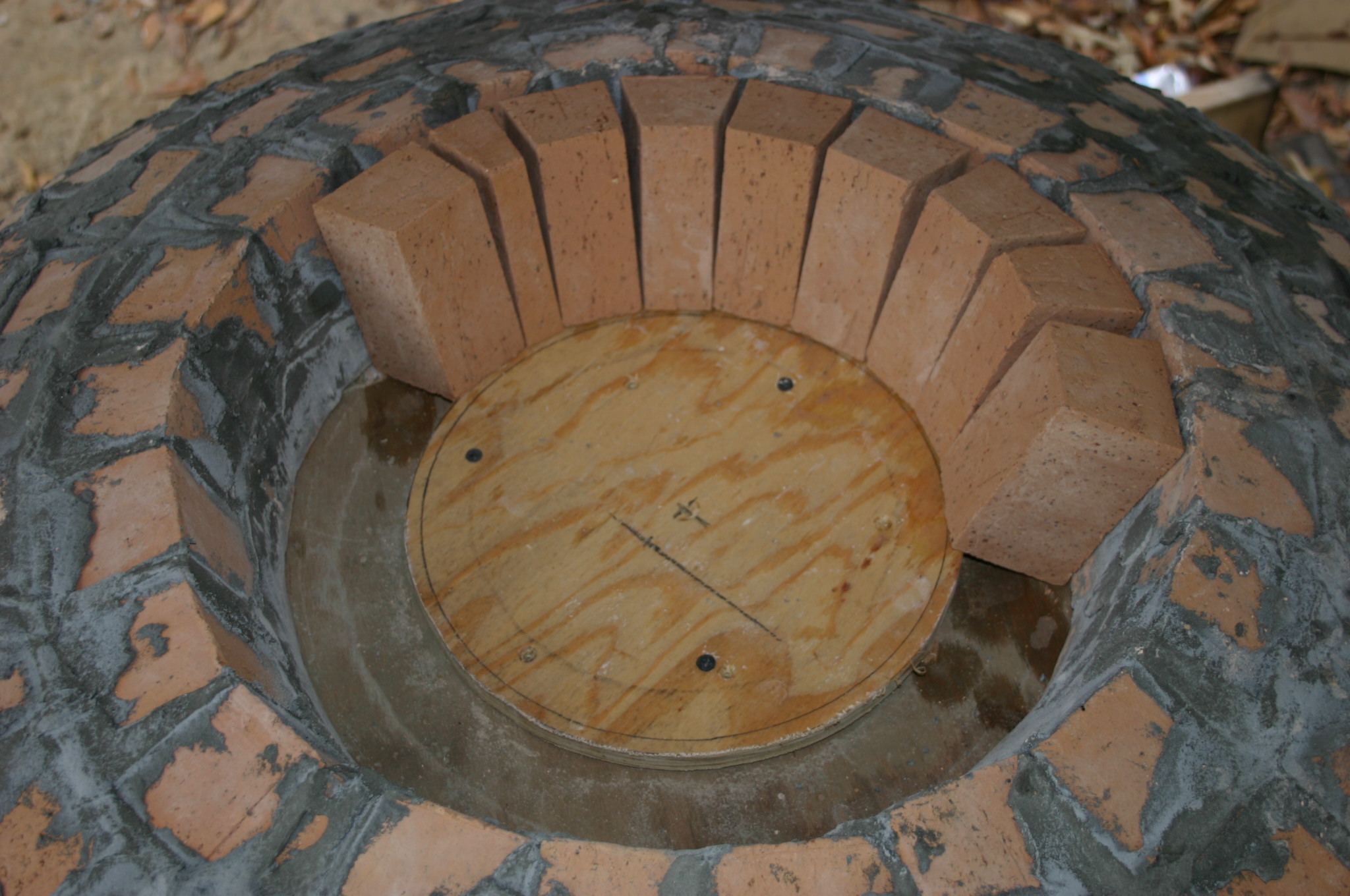

                        Re: Wet premix mortar - crumble risk
                        I would like to add that after each course is completed, the platform can be lowered for clean up. I used Karangi Dude's method on mine. His platform and car jack idea worked great for me. I completed the first course with the platform and cleaned up that course. I then placed it back inside and fit a few more discs on top of it. The thickness of each circle will be thinner than the one before it. I think you will get a better idea from the pics below.

                        I stated that the form can be lowered after each course is completed. That was the plan, but having a stable platform to work to, and precut brick made closing go pretty fast. The last 3 courses and the plug were completed at one time. I was then able to drop the platform and clean up, like Dave described, while the mortar was still green. Here is a link to my dome closing.
