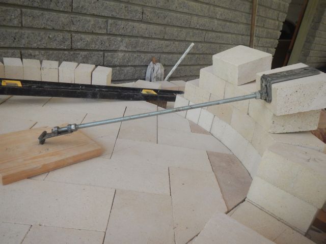

I built the 2 color brick Barrel oven last year and had almost finished it when I found the design had serious flaws. No insulation under the hearth for one. It worked but poorly.
Now I am getting ready to start a 36" Pompeii style oven. I have been lurking here for several months gathering ideas and information. Thank you to all the contributors here.
The Location will be in the breezeway which has several advantages. Close to the back door and under cover so the oven will get more use. Also the footings are in place.
The main disadvantage will be the chimney. It will have to go through the roof or angle out under the eaves. Not finalized that yet.

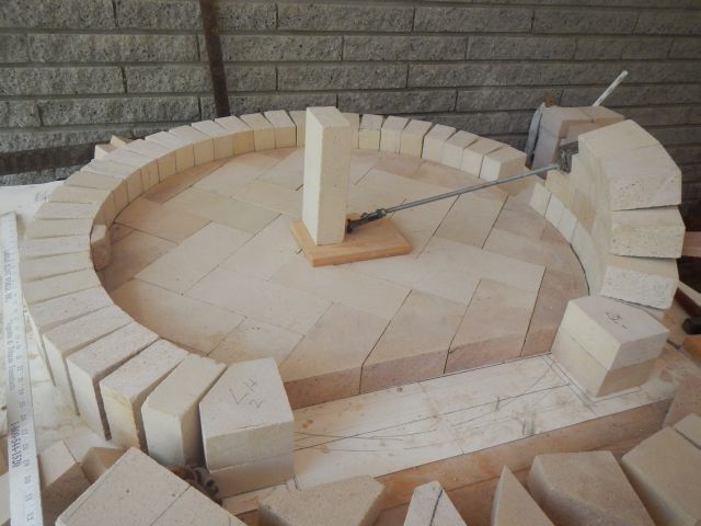

Have cut the hearth bricks and several chains for a trial fit and to check to see what it will look like. Trying out ideas.
My IT tool seems to work now. Had the mounting point wrong at first.
Some photos of the start.
David
