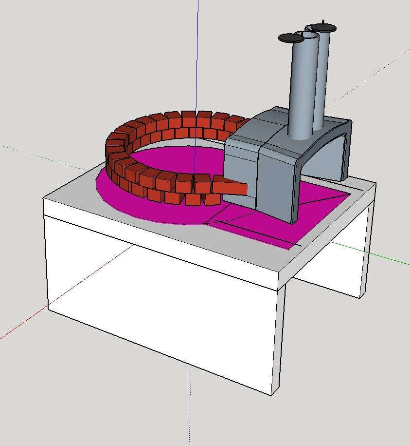

    this is going to be a Pizza Oven / Pitt Smoker combo (The smoker side of things has yet to be added to the plans).
    I have been running ideas through my head for a long time now and finally I feel I am getting some where. I live in New zealand so cost is a big thing ( $4.5 for cinder/breeze blocks and $5+ for fire bricks!) so a big part of this build is weighing up what I want with what I can actually have! At the moment this has turned into a compromise between a traditional full brick oven and a cast perlite oven. I understand (at least I think! haha) the trade offs, and well. . . its better to have this oven than no oven!
    The main thing I am totally unsure of though is the thickness needed for the slab right under the hearth. I have seen designs that go well over a foot, and yet the perlite ovens can sit on top of a wooden trolly with wheels. Obviously I sit somewhere in-between. I don't know where!
    Sorry for the VERY crude sketchup drawings. Im learning the software for this project.
    Everything that is dark grey is a perlite+portland mix.
    The red are old compressed red bricks ( I know )
    The light grey is cement
    Internal dome diameter is 36' - 90cm
    the slab right now is 1360x1640x120 CM But has a 50mm perlite insert (the pink)
    Using fire bricks for the hearth (not there yet as I'm not sure what size I can get)
    To be honest I have only ran the weight calculations on the bricks, But I am guessing there will be around 200KG sitting on top of the slab.
    Can I make the slab thinner? Could I move to using a wood frame instead of cast cement legs? If I did use wood it would be more evenly supported right? Could I go even thinner then?
