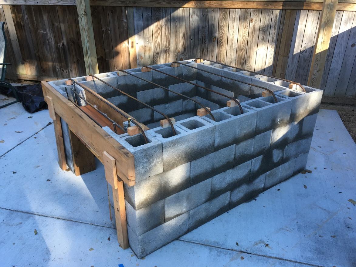

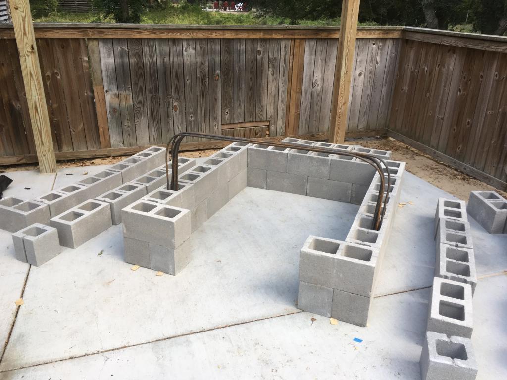

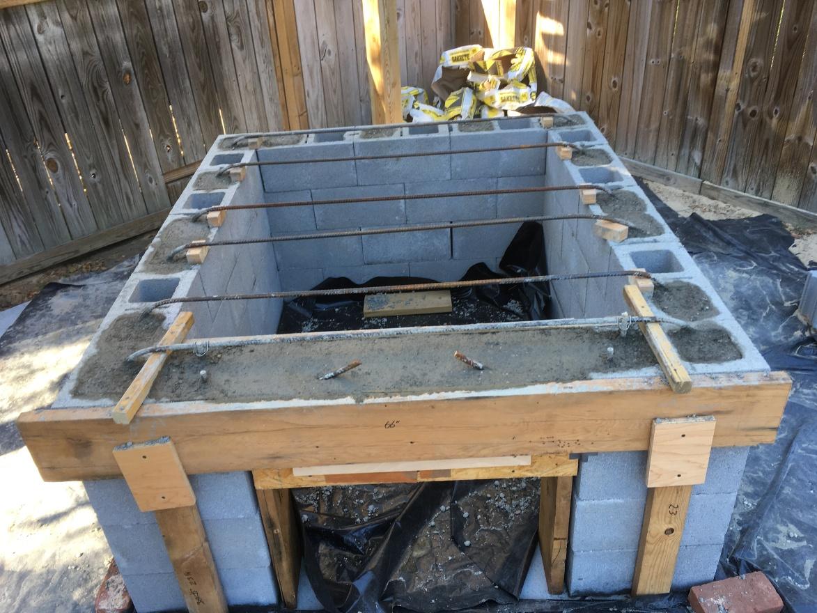

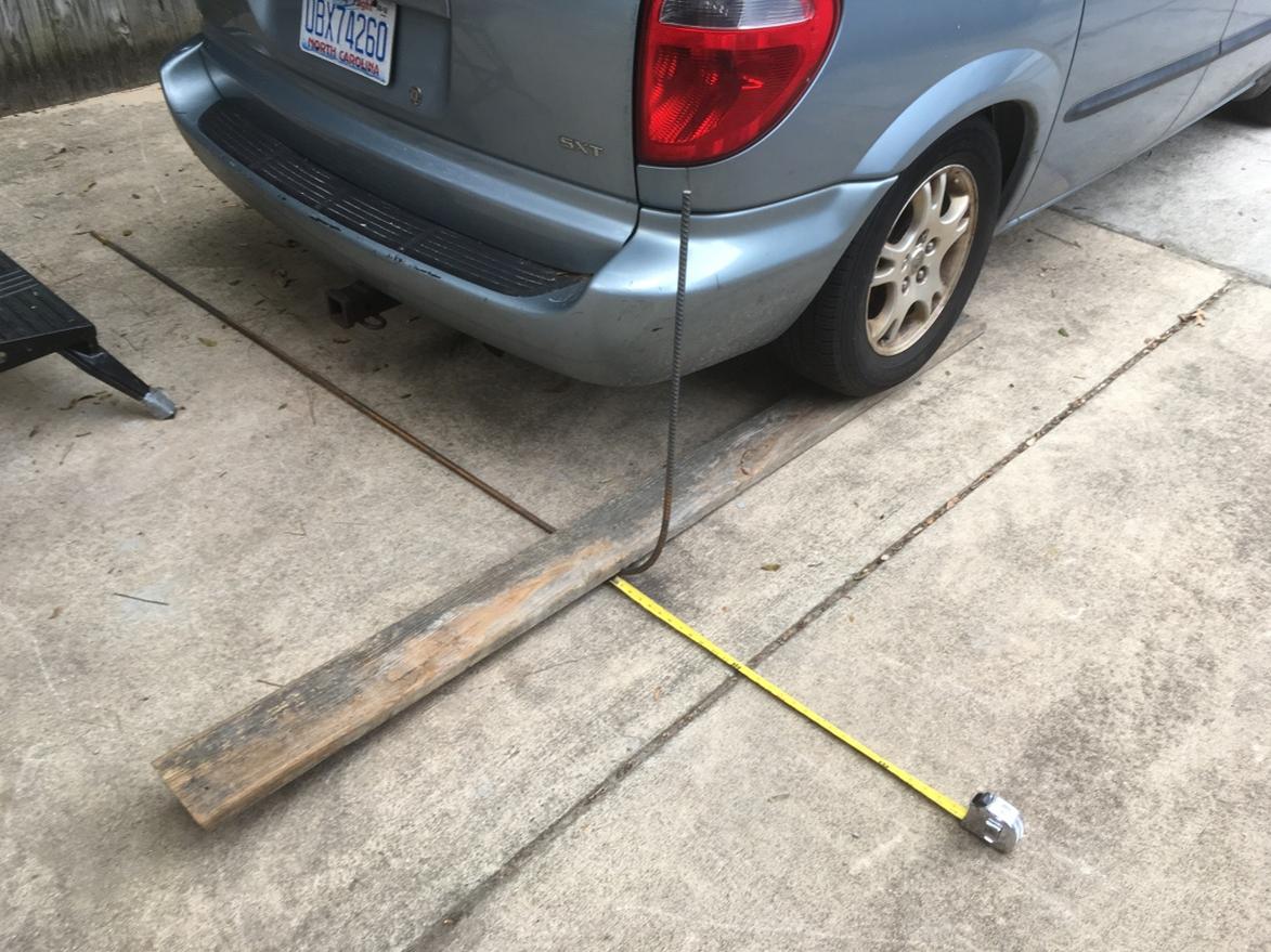

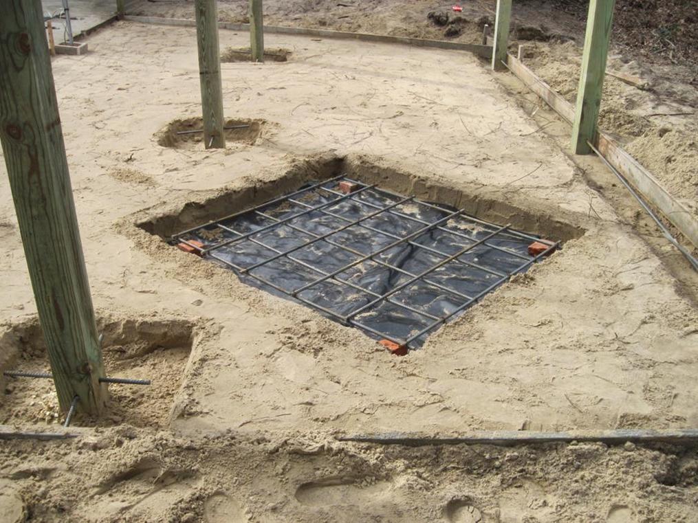

    The foundation is part of a larger slab poured by a redi mix company. The total thickness for the oven area is about 9" with 3/4" rebar for reinforcement. Concrete block was then set and filled with hand mixed cement (ouch!) in every other block core. 1/2" rebar was spaced every 12" or less. I read somewhere that bending the rebar would provide better support, so I used a board wedged under the car to gain leverage to bend the rebar.

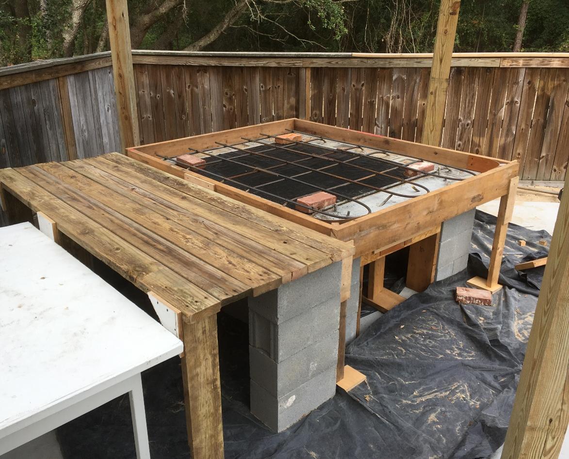

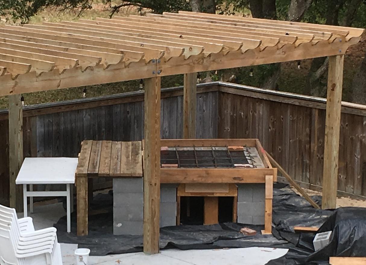

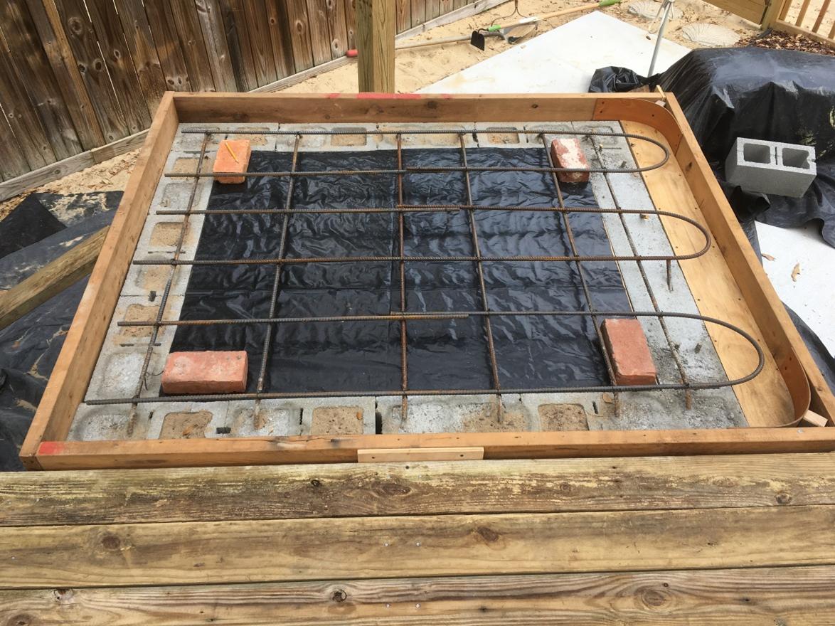

    Next, the forms were set and 28 bags of cement later (with a mixer this time) the oven slab is done. The slab is covered with blankets and kept wet to have a nice slow cure.

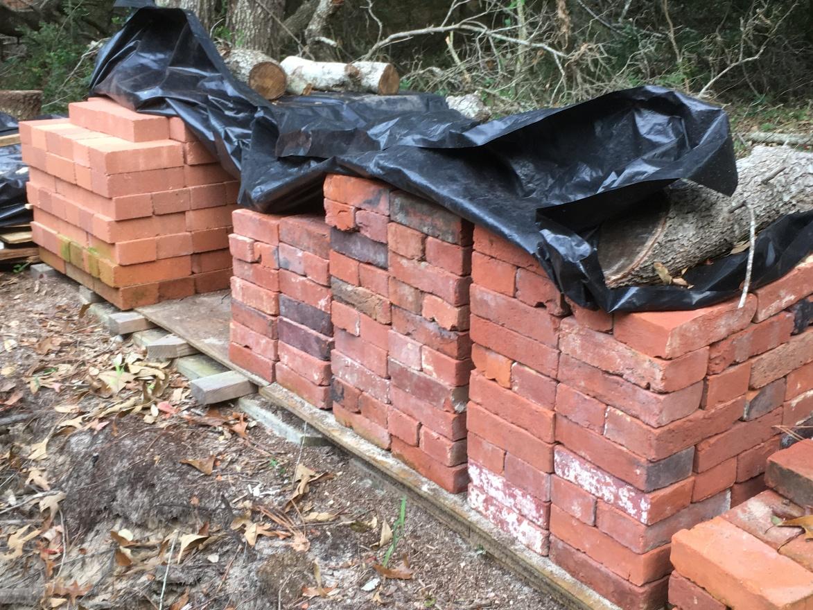

      Here is a pic of a temporary side table built to support the cement mixer which worked out great to pour the cement right into the form. There is also a pic of the two types of brick being used in this double layer build. Lastly there is a pic of how the rebar was bent under the weight of the car.
