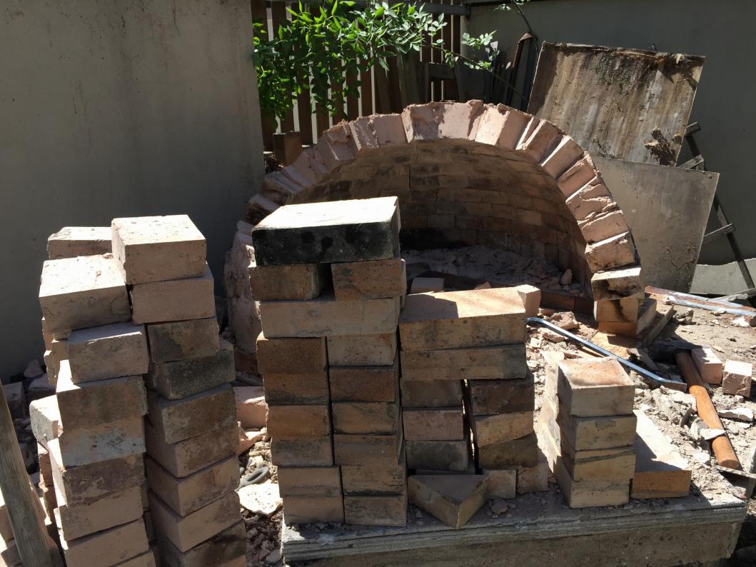

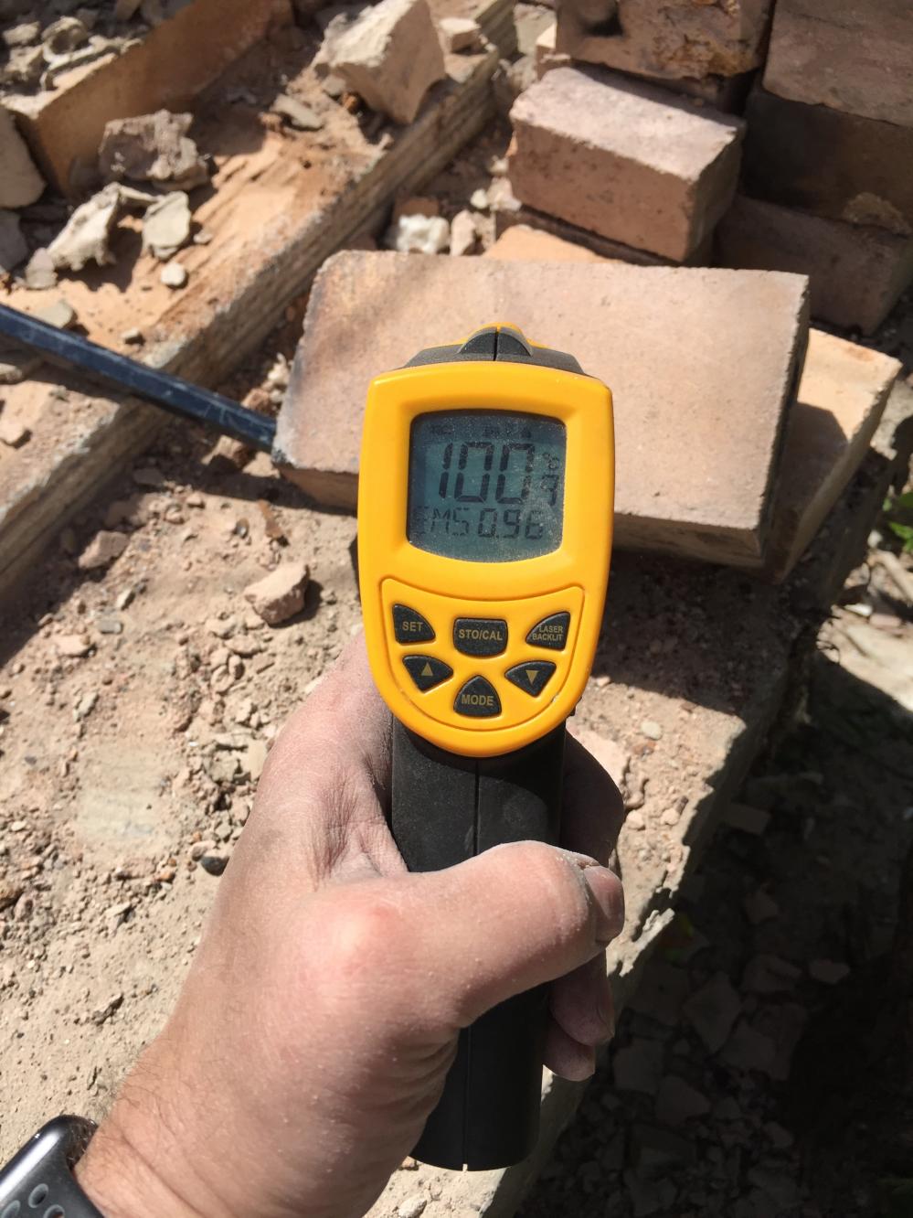

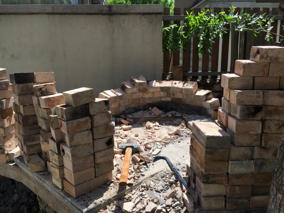

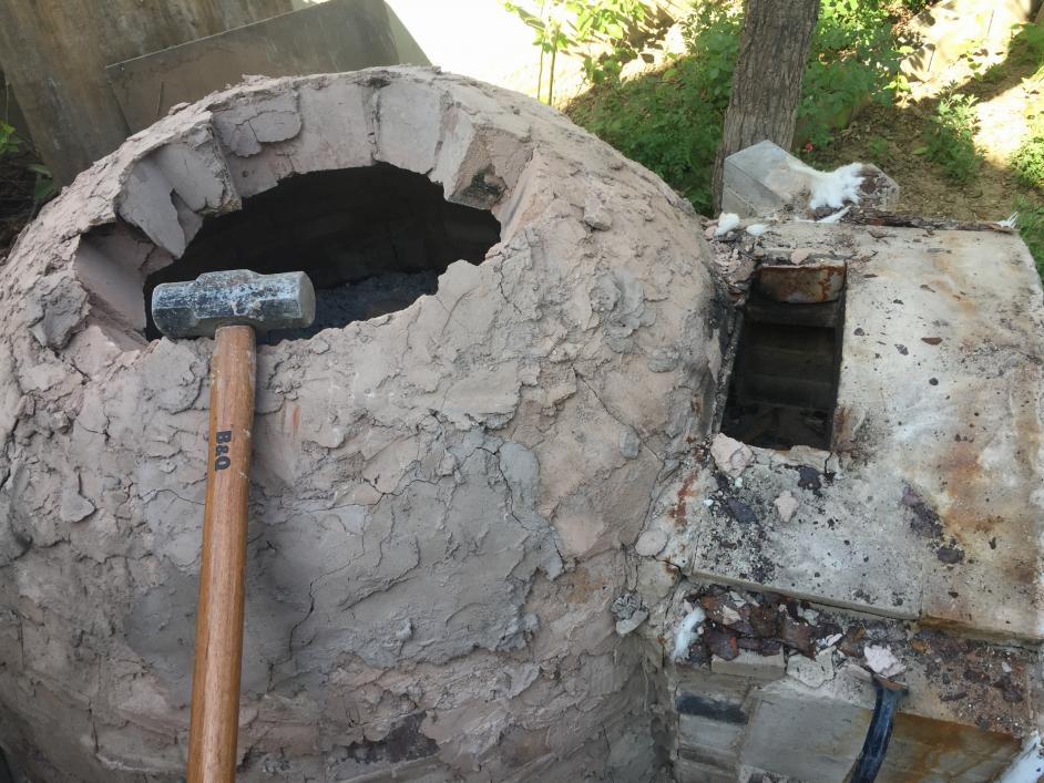

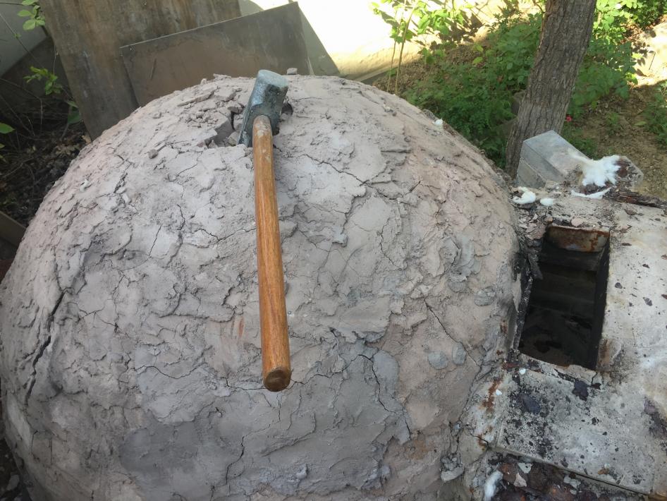

            Well, It's me again. I've finished the dismantle and have to say I am pleasantly surprised that the dismantle went so well that 90+% of my bricks are salvageable! And considering I was planning to downsize anyway from my existing 42"ID to a 36"ID all is hunkydory. Not only my cooking floor is reusable but pretty much all the other bricks. The only ones I feel are not worth saving are the ones that marry the entryway to the dome.
            So, for any of you that find yourself (like I did) in the position of needing to destroy and rebuild your phoenix from the ashes, go for it! Its not so bad. Just be careful of your fingers if you're doing it the morning after a final farewell pizza night!!! Ouch! A 100C+ brick can take some skin off!
