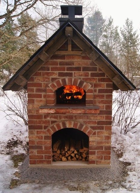

                    Thank you Mike, since this post we have come a long way and our plans are taking shape, we decided to order the Casa290 and will do an outdoor free standing oven, with a pavilion close by also work and counter space. The oven will have a bigger overhang, Germans do like big overhangs on their buildings looks nicer and has purpose, I will attach a picture I have found, I absolute love and hope my oven will end up looking like this.
                    Quick question, I assume the Casa290 does not come with an oven door, do we make it ourselves, I guess it needs a oven door? Also do you recommend lights on the eave of the overhang or the oven front? thank you Alex

                      I think you'll love the oven Alex! The Casa2G90 I helped install several years back did come with a door. It's not an insulated door, but I have used the oven and that door to cook many a loaf of bread (and even a suckling pig). I suspect long term you will get a second door that's insulated...lots of folks on the forum have built one and shared their design. I do think you will need some sort of lighting...seems like I would sometimes start baking in the late afternoon of a winter's day and by the end of the bake it was really difficult to see. Not only difficult to see in the prep area but almost impossible to see inside the oven.
                      Of course if you're doing pizza the live fire gives you all the light you need, however with a no-fire bake (like with bread), it gets very dark in the oven as dusk sets in. I have a BBQ LED light (AA batteries) on a long flexible neck that I rely on when it's dark outside. I personally think having a rope light under the eaves will give you a great evening "look" to the oven and help you see what you're doing...and some sort of light that you can shine into the oven (without holding ) is really important.
