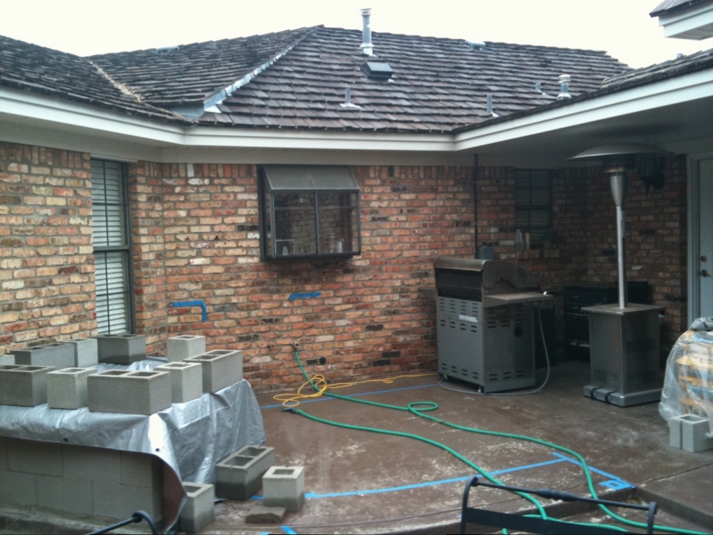

              HEck, you are in Cali, weather has to be way better than what i have. you could do something similar to what i did. Build a complete outdoor kitchen outside on that patio, and use your kitchen window and existing plumbing to add sink and drain outside. You are already covered overhead. The kitchen window becomes a very handy passthrough and saves lots of trips. I screened mine in and use polycarbonate in the winter so i can use year round, even in sub freezing temps. The pic is what i started with.

                    contractor? not sure how much roof he is replacing, but that seems crazy expensive. Normally you will use outdoor materials for an outdoor kitchen so i wouldn't worry about the roof for now. Enclosing can be done fairly easy and inexpensively and still look good. I screened mine due to flies and mosquitoes in the summer. I definitely understand the wind, but the screens will make that manageable too. I did the entire kitchen myself and i am no contractor. You could do the whole thing for less than 10k and that price includes 5k for stainless grills, drawers and an outdoor fridge.

                        I'm liking Texman's solution. A privacy wall or shrubbery, some several feet from that side will also do a lot for the wind. I don't see a need to fully enclose. Putting it outside will save a lot of real estate in your home and will extend your living room/kitchen to the outdoors.
