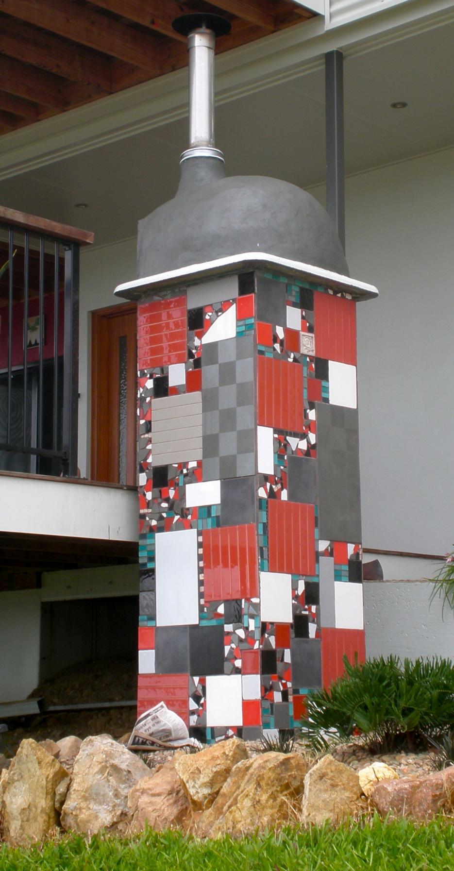

      Timber is a poor choice for an oven stand as it moves and deteriorates in the weather. Your oven should last for generations so make the stand in masonry. Cinder (concrete) blocks are the cheapest way to go. They can be dry stacked and glued with masonry adhesive if you don't have block laying skills. The four corner cores, at the least should be filled with concrete. Here's an example.
Name:	Ryan and Teenas oven.JPG

        Thanks David looks like I've got another idea to draw up over the weekend.
          Also, there is stucco, stone, and brick veneer that can mask the block construction.
