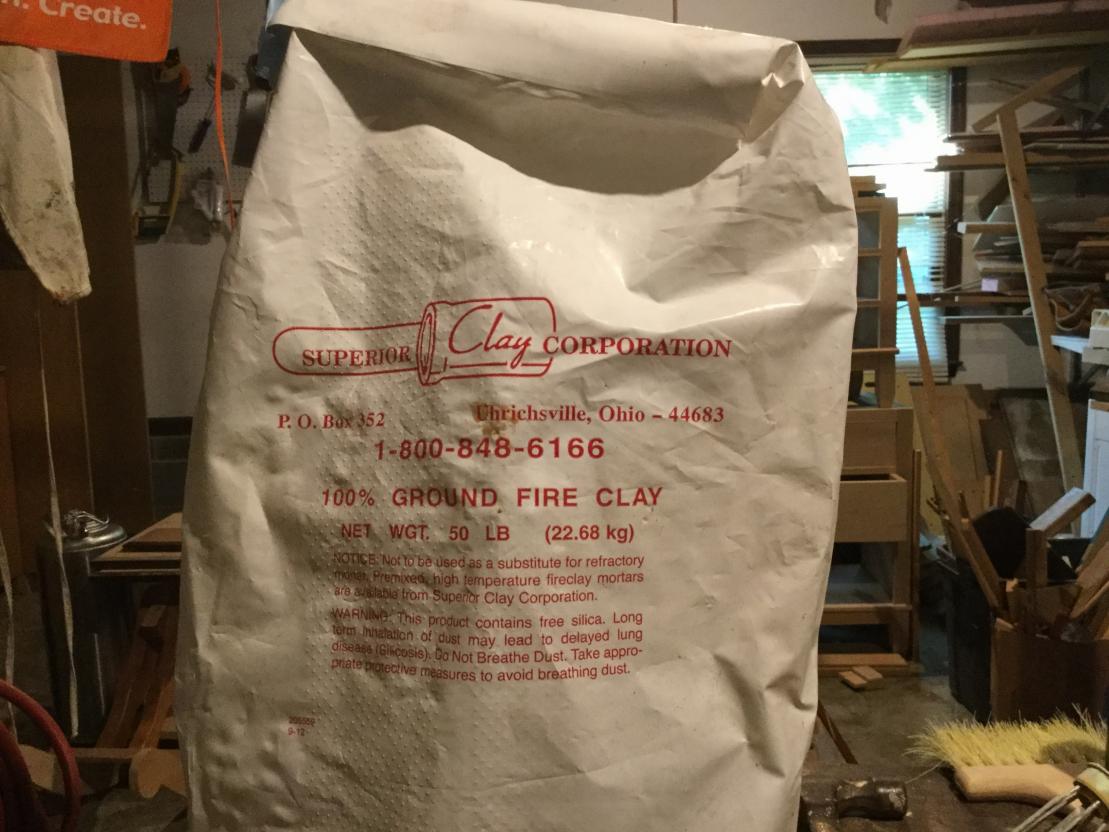

      Humphries in Doraville. http://www.humphriesbldg.com/
      I should have posted this in the other request for materials you made. I have maybe 5-10 lbs left if you want it. I'm in East Cobb.
