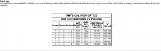

    Sounds like too much water. The consistency should be relatively dry, just enough water so cement can coat vermiculite, don't over work the mix. 3 to 1 ration is not a very good ratio in terms of insulation. For support under the firebrick floor and dome walls it should be around 5 to 1. For insulating the dome walls 8 to 1. Attached is pic showing thermal ratings for different ratios.

      Just a note that there is an error on the table Russell provided. The strength of the 5:1 mix should read 175-225 (not 175- 125)
