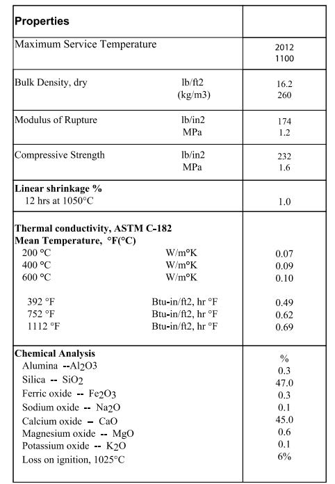

    I've attached the CalSil specs I'm looking at. Price: 2000°F Lightweight CalSil board 2"x24"x36" - $59 Each . I have 4" of Rebar reinforced concrete for structural. And I am thinking about doing 2 layers of the 2" CalSil. Does that seem to make sense, or is it overkill? Do I need to do anything about a waterproof layer, or am I ok with just this?

      I edited the previous post. That should be better. thanks
        That is the zelieblok 2000s, yes? I just bought it today for a similar price. Mine is sitting on 4 inches of perlcrete, so is anyway overkill.
        The specs appear to be similar to the fb board.
