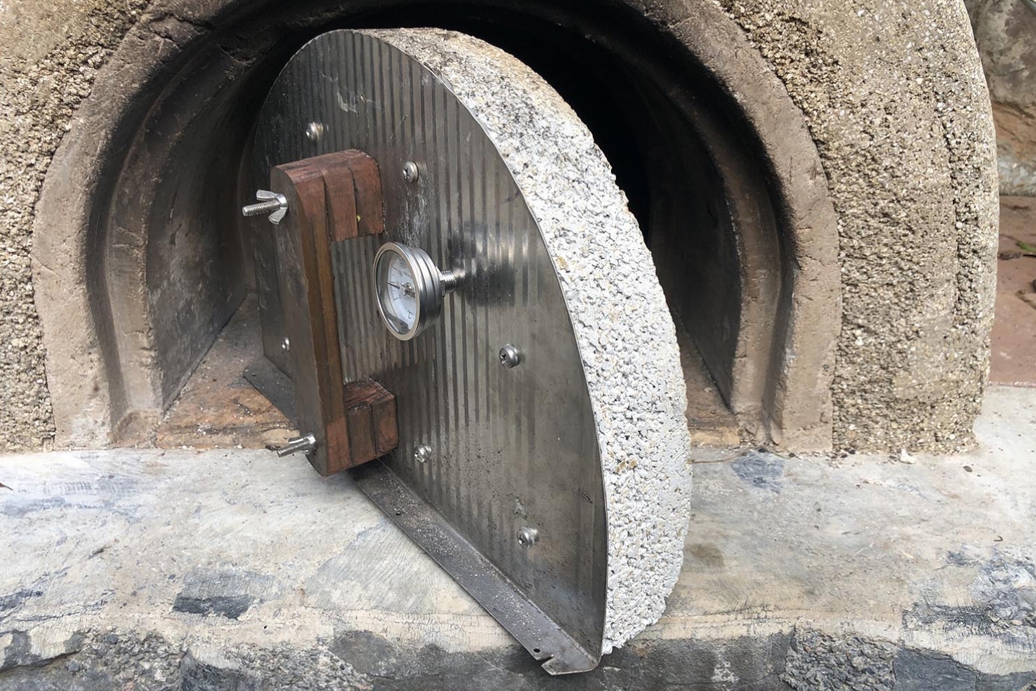

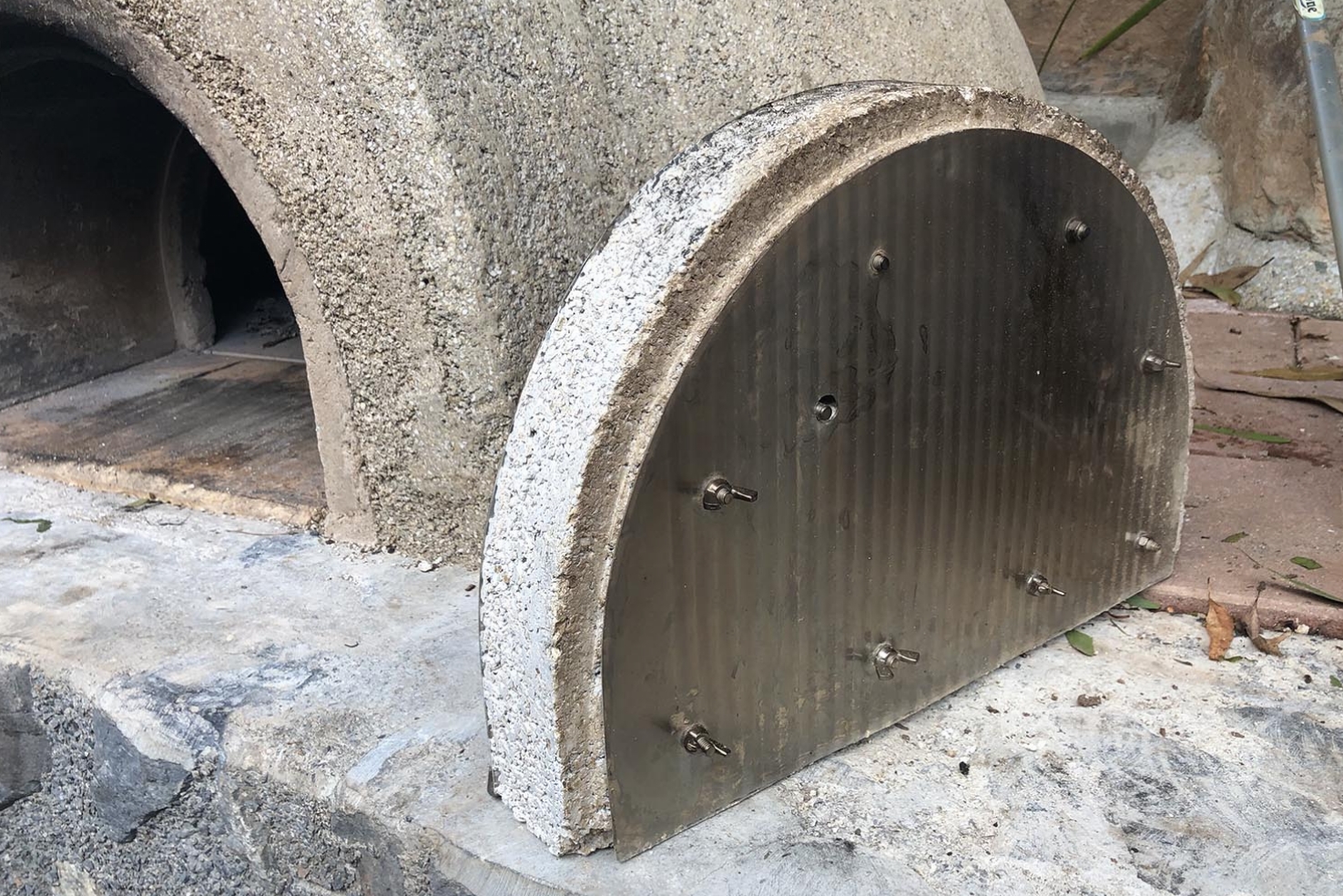

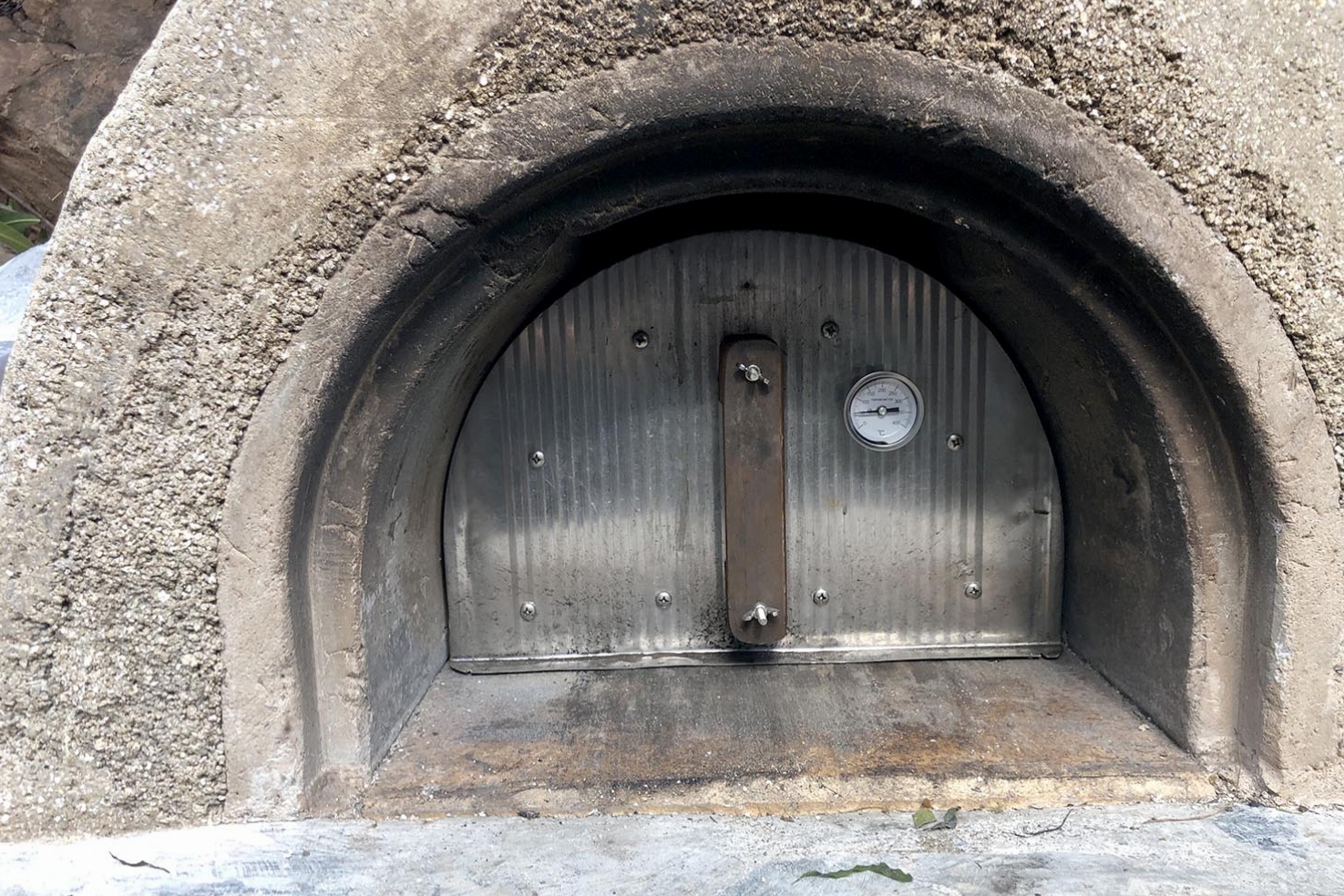

        Hi Guys,
        Been a couple weeks so I thought I'd give an update. Well last weekend it rained most of the weekend finished off with 80-100km Gale force winds and rain coming sideways. So the tarp I put on the oven blew away and basically the oven got saturated and water went down the flue wetting inside. So I did a couple smaller fires a couple days ago to slowly dry the inside out and to help dry the outer insulation layer as well.
        I finished my Internal Insulated door, but havn't had a chance to test it's effectiveness due to wanting to dry it out slowly. So I think I'm good to go with the internal door and a larger fire however this weekends looking like the same story as last week, so maybe not.
        Anyway, I've attached a couple photos of the inner door and will get back with it's effectiveness when I get a chance to fire the oven up again.
        Thanks again for all your help and advice.
        I've also now put on over 2 kg's in the last few weeks from eating pizza every Friday, Saturday and Sunday & I personally hold each & every person on this site responsible for my increasing waistline!! Just Kidding! No really!
        Cheers
        JB
