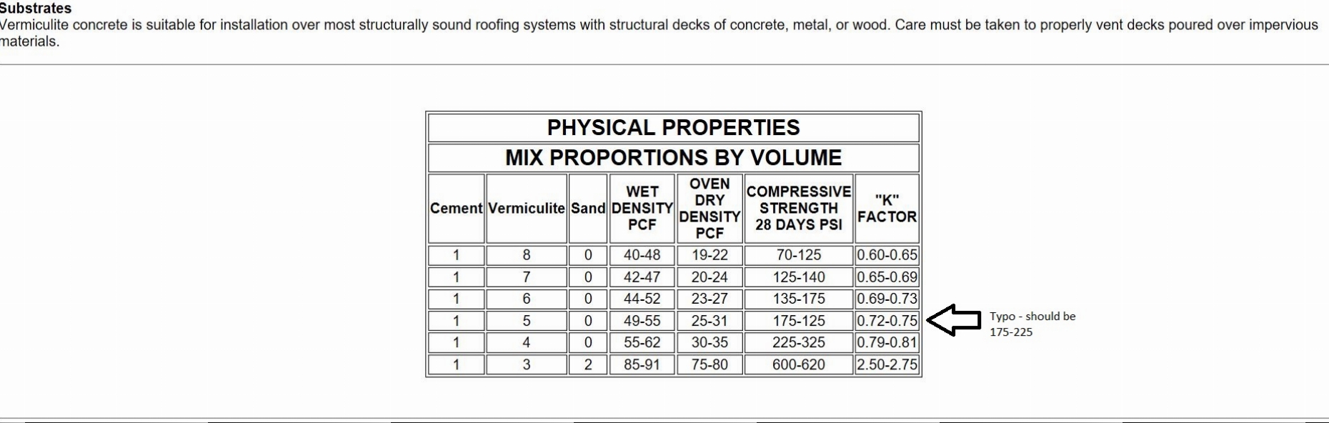

        Consistent hydration is not a problem because of all the free water contained in the mix. Eliminating the free water is the problem especially if you build straight over it. Attached is an experiment i did drying a 5:1 insulating slab that you may find useful.
        Vermicrete insulating slab copy.doc.zip
