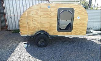

                      Never mind the oven. Ovens are a dime dozen. Is that a teardrop trailer in the background? Mine is nearly finished.
                      Click image for larger version  Name:	Nah.JPG Views:	0 Size:	138.9 KB ID:	430806

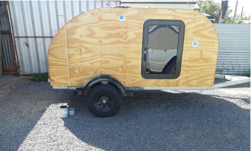

                          Well there ya go. Mine is this one:
                          After 8 months of thinking and reading and looking, I've finally made a start. Last night I did a quick 130 mile run after work and bought a trailer from a guy advertising on face book. His son built it 4 years ago for his aluminium dinghy. The dinghy was sold with his Isuzu truck camper, so the...
