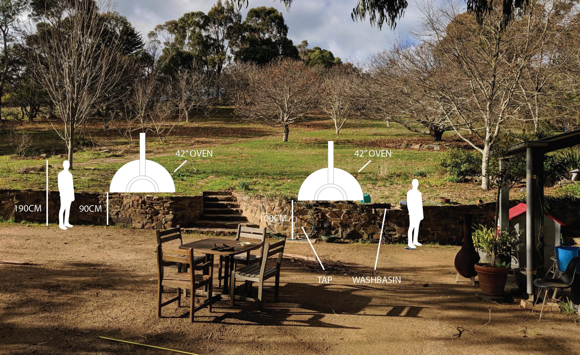

    Hey, what an amazing community, I was quite daunted by this project until I found this forum.
    I have a country property in the central highlands of Victoria Australia, a wood fired oven would be just perfect here given the abundance of wood and long days hanging around the house.
    Check out the attached photo / drawing. I've mocked up two possible locations, both are building directly on the ground (on a concrete base of course) on a retaining wall. The retaining wall is a bit higher on one side, with access to a washbasin and tap, I'm concerned it may be a bit close to the house though (see right of image). The spot on the left is a bit further from the house but has a lower height.
    Also, are there any drainage / water considerations I should be concerned about building on a retaining wall?
    Thanks!
    Sorry, not sure if the photo is working, here's a link to it: https://i.imgur.com/MBjMPcF.jpg

    Welcome, another Aussie builder. There is quite a following in your end of the world. Materials seem to be one of the more difficult and expensive parts of the builds in Australia. IMHO, the closer to the house the better since you still need to move food and supplies from the house but it is what works for you. Abt building on an existing wall, it depends on how solid and what type of footings are on the wall, these beast are really heavy but I have seen it done. Karangi Dude (NSW) has a massive barrel going on right now, Oasiscdm (NSW) also is building a dome (number 2), and Davids (Queensland) is the casting guru just to name a few. If you have not downloaded the Forno Bravo eplans yet do so they are a good baseline and only $3USD.

      I have the pdf and have started looking into materials. I'll read through the forum for a few more weeks before launching into the build. Given it'll be a new outdoor kitchen, I'd like to get it right.
      I tried the photo again < 1MB. Closer to the house was my first thought, however the entry may be a little high for shorter folks (I'm 190cm / 6.2)

        A 42” oven is pretty big. Unless you have a very big family you are unlikely to want to fire it up just to cook three pizzas. Although you may have an unlimited wood supply in the Austrian highlands there is still a considerable amount of labour in cutting and splitting wood. An oven’s fuel consumption is roughly directly proportional to the volume of the chamber. If you scale it down a little and calculate the chamber volume you’ll see what I mean.
        Regarding your location, remember that WFO is really heavy. You must ensure that your retaining wall that it sits on will not be likely to subside. In addition as the base of the oven is pretty much at ground level it may have a greater tendency to wick moisture from the surrounding soil. You will have to ensure it is really well drained and sealed against water ingress.

          David brings up a really valid point on oven size. I have a 42" and there is no question, it is a party oven. It is not feasible to start the oven up to cook a couple pizza. When the "boss" wants to have a pizza for just the two of us, we hop in the car and go to the local wood fire pizza bistro, or heaven forbid, call Dominos....lol.
          A rule of thump is elbow height for oven floor. Also remember, the FB eplans version 2.0 are a good baseline, but dated, there have been many construction technique and material improvements since it was published.

            I was leaning towards 42" due to 1) no space limitations and 2) unlimited wood. I kind of assumed I'd fire it up at start of weekend then keep it rolling until Sunday afternoon. I'll consider a.smaller size though, your suggestion is probably quite practical.
            Regarding the retaining wall, I can't really guarantee it's structural integrity. If I poured a slab of concrete I'm assuming the pressure would exert sideways towards the wall. In which case it's a poor choice of positioning and I should consider building from ground up.
            Back to the drawing board...
