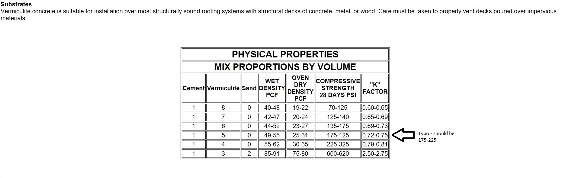

    This will help you of K values for various ratios of vcrete, typically for a floor it will be 5 to 1 and dome insulation 8-10 to 1. DavidS is our local contributor on p or vcrete. Typically hand mix, not mechanically, and David suggest a mix of the two (perlite/vermiculite). The only drawback is this insulation type does require quite a bit of time to dry out before you can lay the floor brick. Once the floor brick is down, it takes a "really" long time to drive the moisture out during the curing process.
    Click image for larger version  Name:	Vcrete K values.JPG Views:	1 Size:	151.5 KB ID:	418498

      Thanks very much for the data. Compression strength is what I'm concerned with.
      Does anyone have experience with using a 7 inch thick 5:1 vermiculite/perlite mixture under a 42 inch oven floor?
      Looks like a 4:1 mixture increases compression strength but I'd hate to lose the insulation quality of the 5:1.
